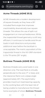

The Cobbler
Oct 24, 2013
26,192
Acme threads deliver lower mechanical efficiency than standard V-threads due to higher friction from their trapezoidal geometry, but they excel at handling heavy axial loads and power transmission. [1, 2, 3]
Mechanical Advantage and Efficiency
    • Standard V-threads (60-degree angle): Provide higher linear force per unit of torque and better mechanical efficiency in standard fasteners because of a steeper helix angle and tighter fit. However, they are prone to stripping under heavy dynamic loads. [1, 2]
    • Acme threads (29-degree trapezoidal angle): Feature increased friction caused by the wedging action of their sloped flank sides. This reduces their mechanical efficiency (typically around 40–50% even when lubricated) compared to ideal square or standard tightening threads

well I searched what has easier torque, and got this
Standard V-threads are easier to turn and require less torque than Acme threads under the same load because they have less sliding friction
60 degree threads form a bit of a wedge. This is what centers a bolt in a nut radially. That force inward or outward, depending on which perspective, is wasted as friction as it pertains to motion.
