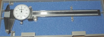

Please tell me what about this makes it so high priced? I know it's a precision tool, but there are other tools with similar precision that are under $50. This is just the kind of thing that makes me wonder, if they put a high price on their tools, people will buy them just because they're expensive.
Uh, no - similar RESOLUTION, perhaps, but not similar precision. Big difference.
A master vernier caliper is quite expensive to make, but it has a couple of advantages over a dial or electronic caliper: first, assuming you don't damage it, it will never change its accuracy over its lifetime. A dial caliper will, and an electronic caliper will eventually fail. A vernier caliper is a lifetime investment that will work perfectly at Year 100 as it does on Day One.
A vernier also doesn't suffer from linearity issues (sometimes a problem with electronic examples), will never jam because of chips in the gear tracks like a dial will, and is completely impervious to oils, greases, steam, solvents, most acids and alkalis. You can even use them underwater - just be sure to dry them thoroughly when you're done!
The vernier never needs servicing (unless, again, you damage it.)
All vernier calipers are very expensive when new; luckily, they're cheap on the used market because a) they last forever, and so there are a ton of them available, and b) the art of reading a vernier is disappearing along with the manual transmission.
(Oh, and just because I'm ****-retentive and tired of misused nomenclature - these pictures are NOT vernier calipers!)

I've heard of people spending several thousands on calipers. Just depends on how much accuracy you want.
autopts
Jul 4, 2009
2,268
Here's a Starrett 24" thats going up for auction near Chicago on the 12th. I'll let you guys know what it went for.
MD11
Oct 30, 2009
1,228
USA
wow, you paid just $80 for that??????? That's amazing if true, I can't believe the auction had no reserve.
I just paid well over $500 for this $633 retail 6" version!
