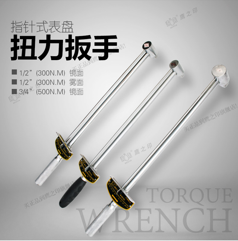

I'm looking around at these "beam types" and some handles tilt, some are ball shaped, some pear shaped, some knurled, some wavy, etc.
I don't know about the tilting ones, especially plastic (they disturb me)...
Otherwise I gather the higher end brands are Sturtevant Richmont, Seekonk, and Tohnichi, while the rest are rebranded or unbranded Chinese variations (or extinct on the market, and they no longer make them without stick on measurements for less than the cost of any other torque wrench, that's the other variation I noticed). Not complaining, just wondering what happened to this statement from the article: "This type of wrench is simple, inherently accurate, and inexpensive".
Anyway I've attempted to order a couple of high capacity ones from China to see if that's infallible...
wholesale-price-BOSI-great-1-2-Dr-socket-torque-wrench-tension-wrench-0-300N-m-BS365330.jpg
Kind of a unique handle on this one... :question: Yes and no, there are a few alternate colored lookalikes with different brand names (but most are wholesale imports, orange, green, etc). The other one I found with a fixed knurled handle says it's 0-500 newton meters, if that's even possible (3/4" drive though, might be, if they send it to me).
Oh, here's a pic of those types side by side.
Looking to get one of each to distinguish between them (or maybe I'll start a collection with different colors )

So, you are ordering some junky Chinese wrenches to see if they are infallible regarding "simple, inherently accurate, and inexpensive". Isn't that what they call an oxymoron?
You are completely wrong about avoiding the pivoting handle style. The top of the line Sturtevant Richmont has the pivot point handle to make sure that the length of the beam is assured. Any solid handle adds even more variability depending where you hold it.
It is already known that the down side of beam wrenches is reading it. I put a piece of electrical tape on the desired reading to help a bit.
You also know that the torque process is +/- 25% accurate to begin with, right? So, debating about 1-5% error from reading the scale is rather moot.
But, to answer your question (in the title), the reason for different handle styles is that the ball and/or pivot styles better guarantee the correct beam length. The solid handles will tend to appear on the cheapest, junkiest ones.

"The operator must use caution to apply loads only at the floating handle's pivot point"
The wrench is calibrated in a certain way, so the handle needs to be accurate for length. The 1/4 versions have a ball, but the effect is the same. The 3/8 version has a more proper handle with a pivot so you can effect more purchase. But if it was just a handle, you choke up or down you can (presumably) mess up the way the steel bends and the measurements. :dunno:

Okay, going back to these, the first one I ordered has arrived, and I'm pretty sure its scale is painted, not a sticker (wouldn't want to scratch it to be 100% certain, or actually there's a miniscule peice of wood embedded in the paint, so now I'm positive). Only problem is, the handle stinks (literally, it's that harbor freight rubber smell from hell)! I thought it looked like nylon/plastic in the picture. Slips right off though, so I'll try to replace that part (with some other type of rubber I guess)...
The other thing is, it's the same length as my 150 foot pound one, but has a 220 foot pound scale (at 300 Nm). Not sure about that, unless I'm doing a handstand. Could be longer, but for what these cost it's pretty good, with thicker steel (should outlast its counterpart with a sketchy scale), and the 3/4 drive wrench with a knurled metal handle would be closer to what I was going for, above and beyond that.
What else? The 13mm (1/2") steel rod extends 3.25" past the scale attachment for that handle to fit over, which is 4" long, and maybe I can extend it for higher torque. No wait, then it wouldn't be very accurate. I guess it's the Bruce Lee model... :ninja: Gonna have to do some serious kung fu to slo-mo 300 Nm laterally (torque chi).

As freeman said the pivot ensures the applied force is always at the appropriate distance to produce accurate deflection of the needle. This type is great for setting bearing preload as you can watch the force build up as you approach your settings.

Then again, without getting too involved, I checked it with a digital torque adapter attached, and used a finger in different places, torquing to the 50 Nm line. Seems to agree closest at the end of the handle nearest the scale (in other words, where the handle would start if I had the grip on there). It's really touchy though, I mean the amount it was below 50 from farther back would also spike above it from close up, so, as a rule of thumb, you could go a little past the mark, or not, depending on where you held it, for that to be just as accurate (since it changes every split second while I'm trying to hold it steady). I'd want to use a ratchet strap or something similar for careful work, because a hand applying variable pressure (with or without a pivot point) isn't as exacting, especially at higher torque. I'm sure some of this is due to me using it laterally, but at least it illustrates that your arm alone will potentially eliminate any advantage of the different handle designs (maybe if you hold your breath though, speaking of smelly handles, ah... so that's their angle).
