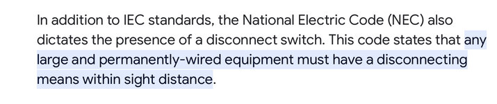

Dont forget Disconnects for each device!

BTW the compressor will need to be hardwired
