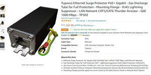

Or you if you live in area with a lot of rain and lightning (I don't), you could simply buy a surge protector :dunno:
I have a POE IP Cam with about 300' of outdoor rated Cat6 running to it in my backyard, and I have never had a problem
Good for you. I wish you the best of luck for the future. As long as you don't experience a somewhat close hit, you're good.
I'm just putting the info out there for those who are interested in doing it the right way.
Lightning arrestors are only as good as your grounding sysyem, which most residential buildings don't have.
C.F. the Motorola grounding bible.
