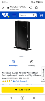

Greetings! I have fiber running to my house from the local internet provider. I have a Netgear NightHawk router which is in my utility room (Downstairs). From there, I have cat 6 underground in conduit to my workshop where I have another Netgear router. My bride would like to use wireless security cameras on our property. The NightHawk router will not reach outside very well. I got online, and located a WiFi extender and booster that connects with a network cable. The house is already wired with network connectivity. My question is can I simply add an extender upstairs for use with network cameras that will reside outside? I appreciate any help that can be provided. I read somewhere that the plug in extenders (into wall electric outlets) without ethernet cables don’t work well, so I am avoiding those.

Easiest way to do this is transition your WiFi to a mesh system that offers "ethernet backhaul". Netgear Orbis are great at this. Same WiFi system in the house and workshop, and the shop WiFi connects to the house with your existing Cat6. One wireless name, unlimited possibilities.

My shop Wi-Fi is the same as my house now. Seamless integration there. I could buy another router for upstairs, but seen the extenders and question if they would work for adding wireless security cameras. My main router doesn’t reach well outside.

"located a WiFi extender and booster that connects with a network cable."
This is wired backhaul. It's basically an access point. It should work better than a wifi-to-wifi extender.

Thank you! The shop is not the problem. I have that squared away already. My issue is my house Wi-Fi. I need an extender for the house. The wireless access point is in the basement. I need better reception outside for cameras. I can plug in an Ethernet cable to any extenders on the main floor.

I'd just run a cat6/7 cable outside your house from your home router and install an acces point. You don't really need an extender. You can do the same in your outbulding. Run a cable from your router in there to an external access point. Depending on the layout, that should give you a lot of coverage. Access points will give you full bandwidth but you likely don't need it.

OP, you are looking for whats usually called an access point, and is probably how your router in the garage is configured. You can absolutely configure one or many more to extend your wifi coverage as needed. My only caution is to spend some time looking up wifi channel and signal strength, the more wifi routers or AP's you install in your house, the greater the chance that they can interfere with each other.
Most of the time when people talk about wifi extenders, they are talking about ones that connect wirelessly (also now being called Mesh systems). Since you have the cabling run, you are much better off going that route for the best speeds and service.

If your house is wired for network, then you just need access points. You can put them inside by the windows, or get outside access points. I run a similar setup at my house. Modem/Router in one end of the house and then I run from the router to a switch in my basement. That feeds Cat6 to my house where I have access points on the other side of the house (hard wired to my router/switch) and then in my shop.
When you buy cameras, most of them will be 2.4ghz. They have better range than the 5Ghz devices, but less speed. Won't matter for a camera. That being said, I'd buy dual band access points (2.4ghz and 5ghz) so you can have high speed around the house on devices that support 5G. I'm a network engineer by profession so if you have questions, drop me a PM.

No tech guy here but if you put a Netgear extender in your attic, it should reach the cameras in the eaves.
I just wouldn't let anything else connect to them, "forget" them in settings.
I have one in the shop and it's hardwired with Cat5e. It allows me access outside of the shop too.
Can you get a spot in the attic to hook it up ?
I think this is the one I bought or a series prior.

Most systems, including older wifi systems can be configured to be wired in and set up as a bridge or "access point". The master system doesn't have to know about it, it just looks like another wired device.
