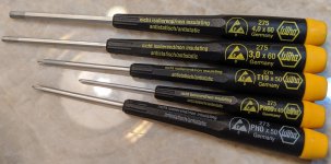

first of all, the printing on the handles is kind of inconsistent.
some yellow, some gray, some white ink.
some printed straight, some printed crooked.
some printed fine, some bold, some blurry.
