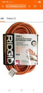

The chart is showing 10 TO 12 amps. And that's of the appliance not the breaker.
I read it as 12A at 240V but regardless. A comment was made earlier that it could have been overloaded and you replied it's a 15A breaker that didn't trip so it wasn't overloaded. Im imagining the lawn mower draws more than capacity of the cord at that length.

I am guessing the majority here have never used these cords they are commenting on?
These are heavy duty. The 50' is rated at 15A. The 100' is rated at 13A. Specifications straight from Ridgid right on the packaging. Regardless of brand, it is not uncommon for pro grade 14ga 100' to be rated for 12-13A.
Again, these are great cords and I have never personally experienced any issues with the connectors.
Ridgid also states Full Lifetime Warranty in print. If I was the OP and had a local HD, I would definitely see if they would comply with that claim.
Thanks to the mod who cleaned up this thread and left it open for others to gleam the valuable information.
You guys have more patience than me. :lol:
OK I lied lol. Just wanted to comment on this. First I agree they are good cords I have one or possibly two myself (all my extension cords are 12 GA though). The 15A rating is good for 50'. Daisy chain two together and current capacity drops. Their 14/3 100 is only rated for 13A (see below). Seems the 800 lb gorilla in the room is what is the current draw on the lawn mower. Seems obvious to me it's likely greater than the capacity of the wire at length used and damaged the ends. (OP also stated he's connected three 50' cords together which would further degrade current capacity but that's another issue). IMO Ridgid may or may not replace it under warranty depending on who reviews the claim but I personally feel this was likely not caused by a defect in materials or workmanship. Furthermore even if the cord is replaced I suspect it's likely to happen again if continued to be used in the same manner as it has been. My $0.02.
ETA sorry I missed that you commented on capacity at 100' my bad I missed that when I read your post. My apologies.

IDK. Maybe your mower is getting old and drawing more amps than it had before. Maybe you damaged the cord when you ran it at 150'. Maybe the ends were loose and it arced. Maybe there was a voltage surge in utilities when you were cutting lawn. Could be many things. What is the current draw (actual) of the mower? Until you figure that out it's all speculation.

Whether it draws 10 amps, 12 amps or 14 amps, all manufacturers design in a margin of safety so an amp or two over the published 12 amp spec won't burn your house down. And with a 15 amp breaker, it couldn't be more than that anyway, right?

And 6 amps according to chart above if you ran three cords together, right? I'm really not that interested in this good luck I hope they replace it for you.

Yes it could be more than 15 Amps. Most breakers have trip curves that varies the time it takes to trip based on how much extra amperage it is seeing. They don't just automatically trip the instant they see more than the rated amperage.

3 ) believing that the plugs are rain proof is probably the source of the problem. Water = corrosion = resistance = heat at plug ends . Results may vary
