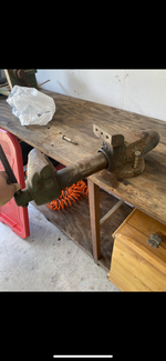

YepThere is a date code stamped on the bottom of the slide. See if you can pull the dynamic jaw all the way out and see what that date is. But it looks like a great example of a Wilton. Doesn't look destroyed, as some do. Grease it up and it will give you great service for many more years.
$125Known here as a 4" bullet. What did you pay?
I would not have know what a deal it was except a friend of mine said it was worth it. I am brand new to this and he has a huge collectionYou ****!
Thanks for the feed backGenerally a nice Wilton machinist vise... and by "nice" I mean one that hasn't been beaten on by street gorilla's wielding sledge hammers... from what I've seen these vises in the 3" to 5" range fetch around $100 per inch of jaw width, plus another $100 or so if the swivel base is present. So if I were selling your vise I'd ask $450 to $550 depending on how badly I wanted to sell it. Your friend did you a great favor! Buy him a beer.
My 2-bit guess is that is a 1980's vise. Just a guess. What is the date code on the bottom of the slide?
This vise will outlast you. you'll need a set of jaw inserts and if you search ebay you'll find a swivel base for it. How wide are the jaws?
4” jaws. Did not find a date code on the slide anywhere.My 2-bit guess is that is a 1980's vise. Just a guess. What is the date code on the bottom of the slide?
