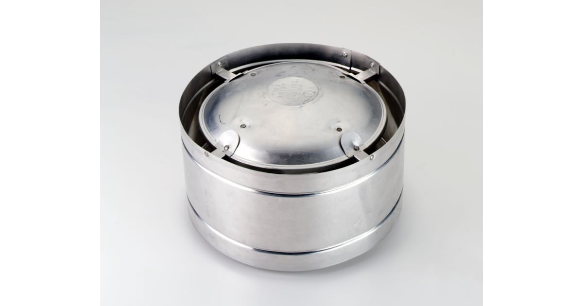

1st year i had this heater on very windy days (west wind) it would kick out the heater and cycle. 2nd year i bought the endcap in the picture which is supposed to help, it did, no issues last year. Today the wind is heavy, swirling mostly out of the south and the heater kept cycling. Anything else i can do to help with this wind blowing out the heater issue?

You could try a tee instead of the cap.
Going out the roof generally has less issues ove sidewall venting in regards to wind.
mopar4u
Nov 25, 2012
131
i knew out the side was a risk to this but was easier to do.
if i put a tee at the end instead of the cap, do i leave both ends of the tee open or cap one end? And would having the tee perp or parallel to the ground be better?

I've got the same heater as you in my 24x40 metal building (75k), and I've got this cap on mine going out the wall. No problems what so ever in about 10 years.vent.jpg

Agree …….no up over the roof line on the horizontal power vent. TEE end cap will likely work. The TEE can be up and down or horizontal. Mushroom cap might also help.
Typical Instruction:
Horizontal Termination
The Horizontal Termination is used to terminate a horizontal vent system. There are several different Horizontal Termination styles available. These include the Mitered Termination Screen, an Elbow Termination and a Screen Termination. All Horizontal Terminations install the same way by connecting them to the vent pipe via standard Ring & Tab Connection method. The Horizontal Termination must terminate a minimum of 6” from the wall (See Fig. 16 & 17).

Thanks for all the ideas. Today wind was coming mostly out of the south which would be directly at the vent. I do have a little room to shorten the termination, i want to make sure i clear the soffit/keep warm exhaust out of attic

If you had the problem with the wind blowing directly at the termination cap I would not expect that shortening it would do any good. My next step would be to try the other style of high wind cap.

Would it be any help to put a 90 in then the cap? If i have to stick with duravent i dont see other options for caps.

It would be cheaper to build a wind shield out of sheet metal and fab around and fasten with zip screws. or buy a 24" and stick that through and silicone back up and throw cap back on? it looks like you have plenty of space from the soffit, but i could be wrong

Wind is not even necessarily the problem, even if you shield it. The pressure differential of the inside of the garage to the vent outside could be increasing or decreasing the draft.
Another solution is to convert to separated combustion, and have the intake air coming in on the same side near where the exhaust is. Then the pressure differentail is minimal because they are both on the lee or windward side.
