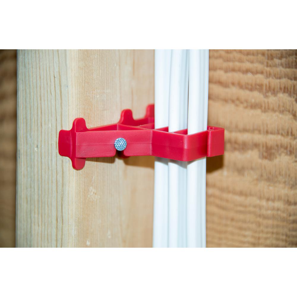

I am wiring my shop. I have a 200 amp sub panel in the front corner.
The trusses are scissor... kinda looking like a flat ''A". I like how it looks and may leave it open, but certainly for a while.
What I want to do is put a tray, or wire rack to lay the romex on so it looks tidy.
Recommendations? I was thinking about some wire shelving and cutting it to the proper width.
Initially I was going to use OSB scrap from the sheathing, but worry that dust and dirt would become an issue. And bird nests.
Thanks for any ideas.
Dustball
Jun 25, 2011
2,081
Hudson, WI
How about this? https://www.homedepot.com/p/Gardner-Bender-Multi-Cable-Staples-20-Pack-MCS-20W/100346576
R
rangermonroe
Mar 23, 2017
5
It's for a horizontal run.
Banging around on Home Depot's site I discovered 2" wire loom which would work better than what I had in mind.

Typically one has to "secure" the NM-romex every 4-1/2' which means every other truss on a 24" center system.
One could go up there and run some strings and mark off nice parallel pathways and simply staple them to the marks.
This is the idea I'm speaking of without a real plan...with planning it could be much neater.
