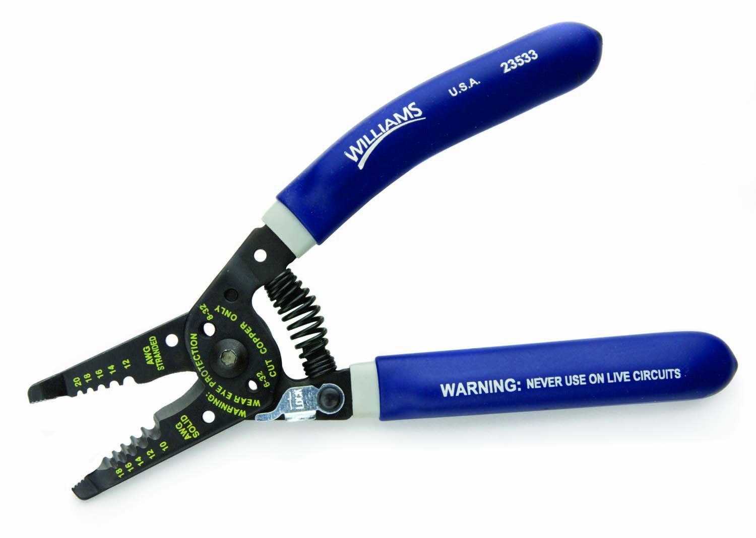

I'll be switching over to these Williams when the Craftsman version is no longer available. They're the same strippers; different color. Same soft grip handles.

Those Imperial/Stride strippers are nice and Klein used to rebrand them but I think I prefer Klein's made in house strippers better, they are easier to lock/unlock. My only problem is they don't lock closed as tightly as my Strides/Craftsman.
