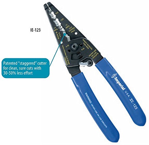

2manytools
Feb 2, 2016
4,367
Mt Pleasant, MI
Or are you referring to the outer jacket? If so, neither stripping tool is called for. Rather, one uses a knife, scissors, or something like this:
Well that's an entirely different tool than you previously pictured. The previous one isn't worth a hoot for Romex. Sure you can use a knife, but not the most efficient method. I love my adjustable strippers you first pictured, but using them by feel isn't how they we're intended to be used, otherwise they would save money & not put an adjustment screw in. Not as fast feeling, than knowing it is set just right, and just go at it.
Can you provide an example of what you mean by forged & "stamped holy things," as I read them as being the same, but the last post makes me think otherwise.
Wamsutta
Jan 8, 2014
10,921
Amarillo, Texas
The Imperial IE-123 can be used to strip the outer jacket of the oblong shaped Romex 12-2/14-2 cables:
Imperial IE-123
Imperial also makes a version for Klein:
Klein K1412
