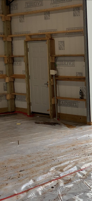

Building a 36x40x12 high shop. Pole barn, so 6x6 wood posts with metal siding. 100amp service to be done to NEC 2017 code and inspected. Interior with be exposed/unfinished.
I haven’t been able to speak with my inspector yet but I’m trying to figure out how to run the wiring inside for lighting and outlets. I’m trying to decide if I should run all pvc conduit and THHN wire or romex up high with conduit drops to the receptacles or what?
Run conduit and/or wire behind the posts and along the horizontal 2x6s?
If anyone has pictures of how they wired their pole barn I’d appreciate it.

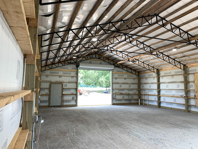

I ran MC cable for all lights to my main light switch. I ran PVC drops from one side of the barn to the other before concrete. I then ran EMT for all outlets. My inspector was fine with the exposed MC as long as it wasn't in an area where it could get pinched. All MC and EMT has a dedicated ground, but they are also grounded back to the main panel.

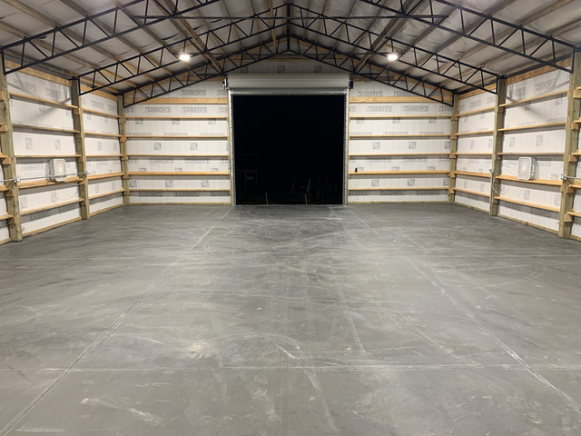

Inspector was fine with the building. I bought it from a local pole barn company and they built it. Concrete is done now! 3c3f2f1608f8759d1e083af69e23db26.jpg

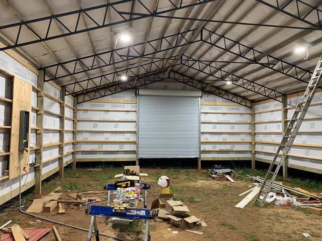

That's why I posted it! We have the same trusses, so I figured you'd be looking for lighting and wire routing solutions. All of the MC wiring was ran along the purlins using steel screw in clamps and then to the trusses where it is simply resting on the horizontal member and zip tied.
Building looks great...almost a mirror on the inside of mine.
