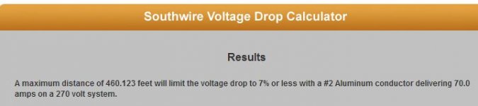

I dont understand, I have read on this forum of several people using this same size wire on a 100FT run going to a 100amp box. SouthWire claims on their site that its rated at 100amps.
See attachments below from the Southwire Calculator

For that application, AL 2-2-2-4 MHF is only good for up to 90 Amps, MAXIMUM. Hence the breaker in the main (house) panel must be no larger than that.

How are you figuring that? As noted above, his total round-trip feeder run is no more than 210 feet. So...
CM = K x I x L / E
where "CM" is the minimum required conductor area, in Circular Mils; "K" is (for AL) 21.2; "I" is the maximum load current; "L" is the ROUND TRIP distance; and "E" is the maximum allowable voltage drop (3% of nominal line voltage). Hence:
CM = 21.2 x 90 x 210 / 7.2
CM = 400,680 / 7.2
CM = 55,650
AWG 2 = 66,369 CM. Hence, 2-2-2-4 MHF is quite adequate for the full 90A.
