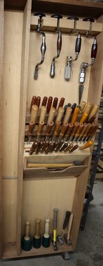

I have a upright cabinet for many of my woodworking tools. My chisels are on the right side door. Made angled holders to keep them organized and easily accessible. Here are pictures of my bench with cabinet behind it. Then the left door. The top middle. The bottom middle. Finally the top right door. Still working on hammer/mallet and drill storage at the bottom of the doors.

Nice setup. I need to get organized lol.
That's quite the brace collection. Looks like you have some old pattern maker's chisels in there. Possibly "pig stickers" in there as well.

Standard C.E. Jennings chisels. Ray Isles mortice and dovetail chisels. Buck gouges. Some smaller dovetail chisels. Couple of Lie-Nielsen fishtail chisels. Some swan neck chisels. Couple of drawbore pins. Crank neck chisel. No carving chisels.
As for braces, the ones on the door I use the most. The rest are being sold or given away. There are more you can't see in these pictures. Probably just under 100 total braces.

I bought a box of carving chisels from a guy that had bought them from someone who got them in Grand Rapids from a furniture maker that closed. The guy I bought them from put the box in his closet in the 1970s and never did anything with them. I think I paid $250.
There are around 150 of them and they are all mid to late 1800's premium makers: Addis, Herring, Maiers, etc. I've cleaned and sharpened most of them. Replaced a few broken handles. Most were still sharp and mainly dirty and thankfully not much rust.
Almost no two are the same. Different widths, sweeps, styles. I have them in my CE Jennings machinist box and overflowing on top and around the box and on a shelf above the box.
I need to start using them now, but just haven't found the time yet.
