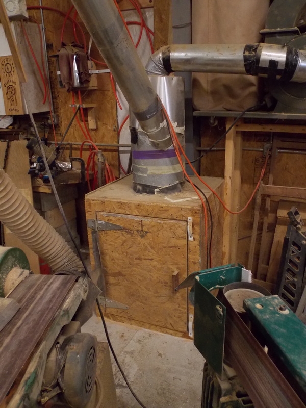

I made a simple trashcan separator for my DeWalt:
y4mZVU4YukHKjpCjfao0Au-0bJYlMhQlOglShZXuZYyKhbUJoVZHu2O14IUmHUrCP3-ohk6iutEhhsfd37e4M24E_wkOx-WAdXcNaGAuWKWacLdE_EQuGIgZbxzq_GpAL2vVMBW7m9uAAuRoxXyydceumbO5GCAaVp8kfoXSZzh45ALMJKJCGSj2DNwdvOjNXjA
Only thing you need to be cognizant about is the level in the trash can. Much above 50% and you'll start blowing chips into the filter bag. I've consider connecting this to my plumbed dust collector, but haven't. I really like how the DeWalt 735 blower will support the trashcan separator lid.

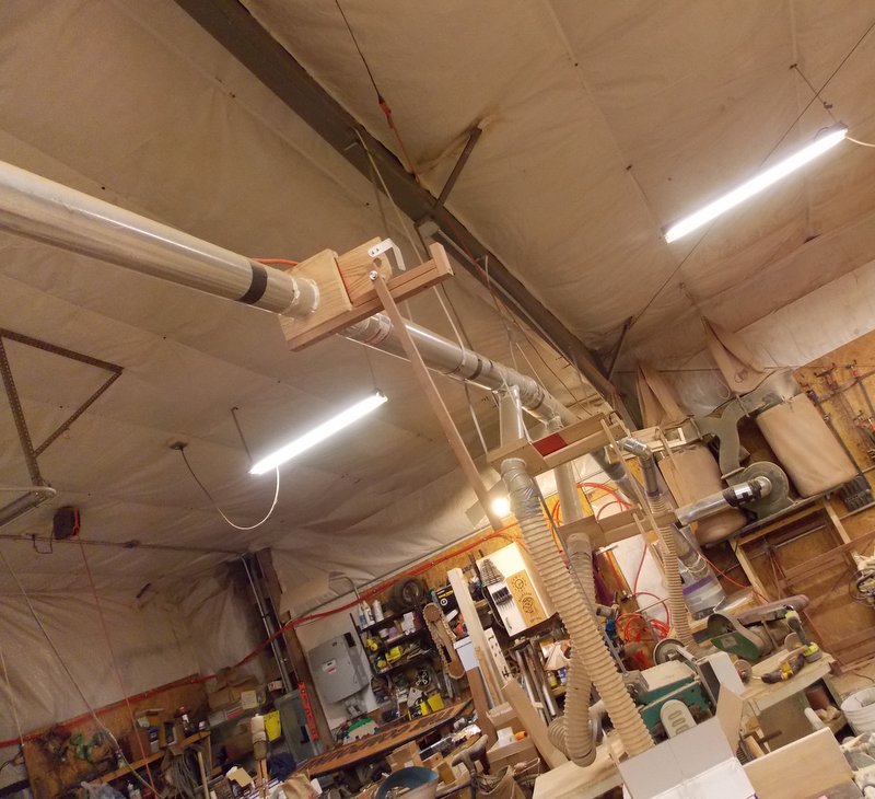

I installed my set up out of the shop area in a separate add on room so it is quieter in the shop area. Ran 4” tube to RAS and fittings for other saws and equipment.

Thought of this after my other post...maybe look into these too...nice for extra cleaning of airborne dust of the fine type.

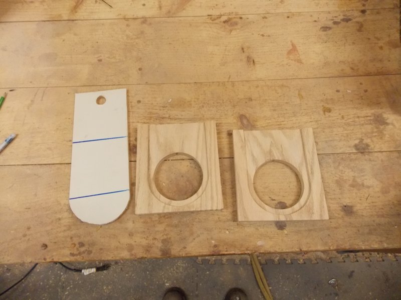

I have a 1986 grizzly 4 bagger looks just like the one you have pictured, it runs almost every day made a ugly as hell separator with a garbage can in the box, as long as I check and the can does not overfill I can go weeks without emptying the bags.
I made blast gates they have rubber sandblasting mask on the suction side they seal perfectly when closed. Good sealing gates are important with multiple machines hooked up.

I have a 3hp shop fox. I added semi truck engine air filters I got for $8 each and a thien baffel. It works pretty good but takes up a lot of room.
I've been building a pentz cyclone very slowly to replace it. 5hp, 15.5 impeller. Huge metal cyclone.. all that fun stuff. In the end I wish I would have just picked up a Clearvue max and been done with it. While a decent amount of money, having it up and running already would have been really nice vs the time of building it.
I have also been working on building better hoods and such for my machines. That has been a biggest improvement i have seen overall regardless of the dust collection system I'm running.
