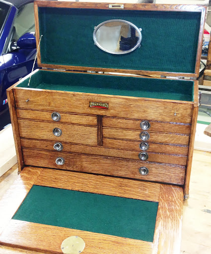

Rockler carries some things. http://www.rockler.com/product.cfm?page=4961&site=ROCKLER
You may have to replace all of the hardware as matching it can sometimes be very difficult. If it is a Gerstner chest, you be able to get it from them.
Also, Gerstner: http://gerstnerusa.com/opencart/index.php?route=product/category&path=61
As far as building drawers, any oak will work. If you want quartersawn oak (which is what most were made of) try Woodcraft stores - I have found it there on occasion. If you sand the existing drawers down and stain everything with a walnut stain, you will get a pretty good match. I made the bottom drawer for this chest and stained everything with a walnut stain (go easy on the stain).

Ken, thanks for the tips! The project chest I have is almost identical to your pictures, just a similar different brand! Mine is missing the bottom 3 drawers though and the front cover piece. Yours looks great! Mine was about $25 at a garage sale in its condition. I think a great deal for that and well worth restoring! - Paul

Paul:
Let me know if you need any pics of construction of drawers or front panel. I have made both. Your deal on that was great - I gave $65 for this one and had to drive to Dallas to buy it (as one of a group of chests). Here is a front view that may help you with the proportions of the various parts of the front panel, if you can scale it. I can get actual measurements if you need them. (This chest was a gift for a friend so I wouldn't have instant access, but could get dims if needed).
