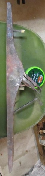

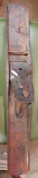

I have reading this thread over the last several weeks starting from the beginning. Not up to date but a little more than half way. I am finding it very interesting. It sparked an interest in wood planes. I watched Paul Sellers utube on restoring a plane and since I like to go to auctions figured I could pick up some to restore. Have gotten several No 5 and No 4 in various conditions. Still deciding which to try and restore.
Last Saturday I purchased a No 7 Bailey at an Amish Mud Sale. It has all the metal parts but lacks the wooden tote and knob. Figured for the $1 I spent on the plane I could find the wooden pieces. I think it is a type 9 and doesn't appear to be cracked. I have taken it apart and it now soaking in evaporust.
Are the wooden pieces from other size plane compatible with the No 7?

Pops--Welcome to the land of shavings. That looks like a really nice #7 that you picked up. The same replacement wood was used on 4 1/2, 5, 5 1/2, 6, 7, and 8. The larger sizes are not very common EXCEPT for the #5, which is as plentiful as stray cats at a fish fry. Your best bet is to find a nice #5 tote donor. I like the #7 size because it has enough mass to keep moving.
