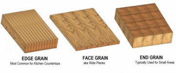

Lumber liquidators, ikea and 99% of the rest of places selling "butcher block counters" do not have end grain countertops.
Frankly I don't understand why they even call them butcher block (they are not.) At best they are wooden strip counters. Be that strip or wide plank (wide planks are more $) they are both functionally the same as a dining table top.
Real butcher block is all end grain, and in countertop form more fragile from a structure standpoint, not to mention more expensive and or labor intensive to produce. Total Stock needed is significantly higher from all the waste turning to sawdust. It's about double granite.
24x120 x 1.5 $1400 in pine ($70 sqft)
https://www.hardwood-lumber.com/countertops/end-grain-butcher-block-countertops/

Real end-grain butcherblock isn't 2" thick. And when it is more than a few times wider than thick, it has a nasty habit of splitting. You'd have to be nuts to use that around a sink, unless you start with something like acrylic stabilized wood, and then you're really just making a corian like solid surface that has a wood end-grain appearance at an astronomical cost.

I agree on all counts.

I think you just sank my battleship.:lol_hitti
A friend of mine had an old very worn proper butcher block incorperated in his kitchen countertop which I really liked which give me the idea.
