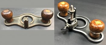

ORPHAN ROUTER PLANE​
I found this at a garage sale one block away from my house. I recognized it as the beginnings of a router plane and I wondered about the fact that there were no numbers or markings cast into it. I dug through the box looking for any of the missing parts but there were none. At that point, I noticed that the post had not been drilled and tapped for the height adjustment mechanism. I thought it might have been a blank for a school shop project until I looked closely at the grungy knobs and saw that they were made of birds-eye maple. It's not likely that a school would have used such expensive wood especially with tiger maple inlays on the top. What the heck was this thing? It had piqued my curiosity so I bought it and it became yet another shop project.
The first thing I did was compare it to my Stanley No. 71 1/2. The base of The Orphan was a bit smaller but the post was exactly the same size. I looked on Ebay and found the missing parts that had come from a Stanley. Since The Orphan was smaller, I got a 1/4" cutter for it. The 17 1/2 has a 1/2" cutter and I'll leave both routers set up that way.
The only part that was not available was the threaded rod that screws into the post. I tried the knurled thumb nut from Ebay on the threaded rod of the 71 1/2 and it worked so I measured the rod at 1/4-24. I couldn't find 1/4-24 threaded rod so I bought some 1/4" bronze rod, a 1/4-24 die, and 1/4-24 taps.
The Orphan works as good as it looks. I'm glad I paid the $1 asking price at the garage sale. I didn't even haggle.

CRS--That looks like a homemade router. It was common for machinists to cast their own. Some are unique like yours and some are just copy castings of Stanleys. They are even a subgroup of plane collecting. Yours is a nice example, especially with your mods. Good work.

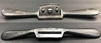

INFORMATION PLEASE​
Does anyone have any information about this no name and no number spokeshave? It came from an estate sale and I bought it because, like The Orphan router plane, it was curiously different. The most obvious difference is the blade adjustment mechanism. It's a little crude. A less obvious difference is the handles. They are solid. Most other metal spokeshaves are convex on top and concave on the bottom. I did find a picture of an early Stanley that had the same type of handles but nothing else about this one is anything like a Stanley. What have I got here, another home made tool?
I also bought two other spokeshaves. One is a solid bronze Cincinnati Tool Co. with a seriously convex sole and the other is an unremarkable Stanley 51. I got it because it was the only Made in Canada shave I have ever seen. Oh ****! I think I've fallen into yet another collecting rabbit hole.

CRS--Nice find on the spokeshave. The three screws give it an unusual look. Most factory made spokeshaves have some sort of lever cap. Maybe this one is user made. But then there were dozens of spokeshaves patented in the late 19th century.
