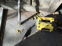

Many hours of clean up later...we're making progress. Drilled the holes today for the MaxJax, but it's too soon to set the epoxy anchors. The nice thing about pouring a slab is if you planned right, no rebar to hit, and full depth holes for each anchor. I just chalked a center line down the slab, marked each MaxJax base for center line, and measured three times. Pilot holes weren't required..I just used the Maxjax base as the drill guide, hammer drilled for 10-20 seconds in each hole, moved the base and finished each hole with the 7/8" bit. Easy peasy.
Drywall should be done next week so the floor epoxy process and Kee-clamp organizing can start.

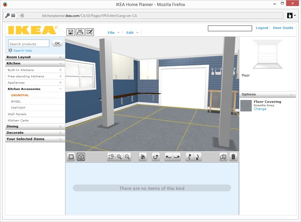

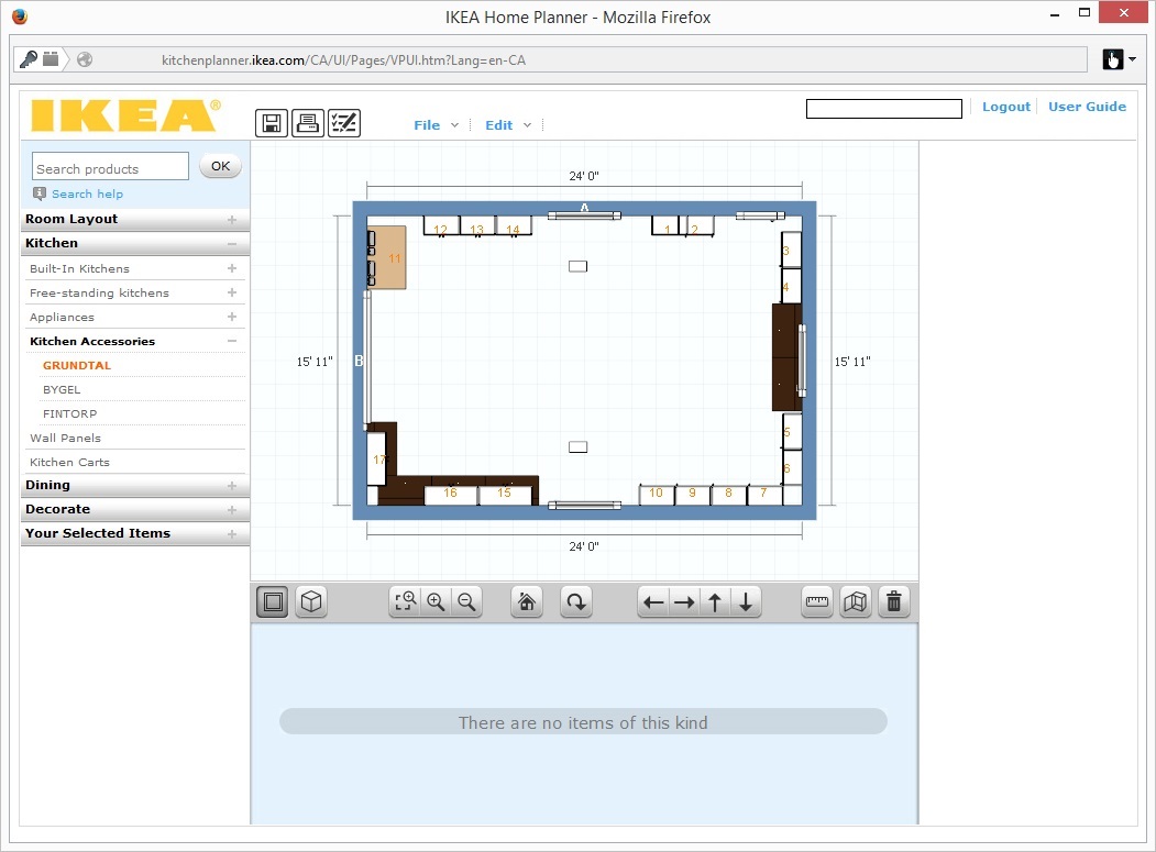

I usually use Microsoft Visio for 2D planning. 3D, particularly in a garage is very useful, but comes with a learning curve, and/or price tag. The easiest 3D tool I've used to date is free, and works using Chrome, Firefox, or IE. Ikea's planner might have you thinking that kitchens are the only thing you can visualize, but you can see here that my shop planning actually works very nicely too. I'm not necessarily using Ikea cabinets..the tool though makes setting up in 2D/3D with a learning curve near zero. The hoist columns are modeled adding "obstruction-wall column", garage door using a "resizable wall opening" benches added using wall mount tables, etc. A very useful tool, and deserves awards for how crazy easy it is to use. I tried at lease one dedicated garage planner but quickly ran into Internet Explorer issues with their setup. The Ikea software works nicely on Firefox, Chrome, and IE 11, both MAC and PC.

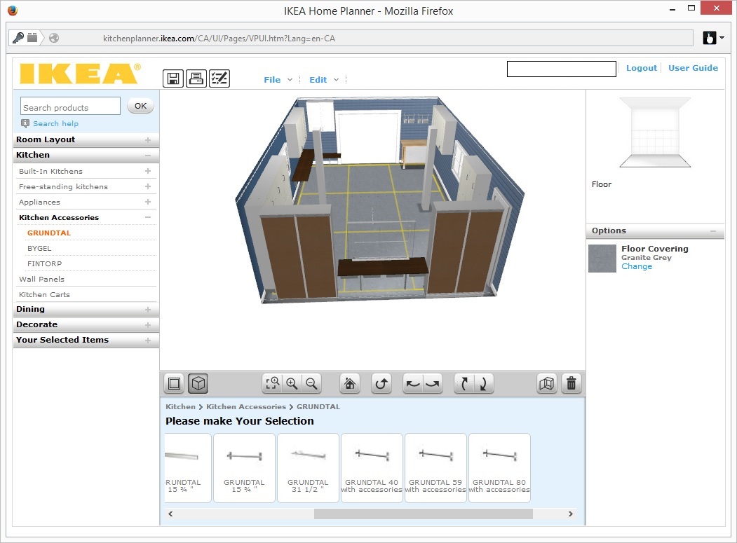

Re: 8ft to 10ft ceiling in 8 hours, $650 ??
Where in the Ikea sketches are the cabinets at?
I drew this up today to make sure all my **** will fit in the new house and garage that I am spec'ing out:

Drive, yep, it was a close fit up top. I'll have to remove the racks once the 6" extentions for the lift pads show up. The pad unfortunately was never insulated at the foundation walls, nor under. So in terms of keeping it warm, we don't try. I only run the heat when I'm working in there. That said, at my business location we insulated over the existing slab, added 4800 sq ft of radiant, then poured two more inches. It's a nice floor!
Bone, you'll find most cabinets you need under "Kitchen" (drop down menus on the left of the design window), then "Built in Kitchens" ...many sizes to choose from. As you drag them towards the walls they will orient automatically to fit your dimensions.
Under "Kitchen", "Wall panels" you can choose wall colors as well as coverings from the options that will show up on the right side of the design window. I've approximated slat wall with the choices offered.
For the workbenches, I just used wall mounted tables under the "Dining" section as you can slide these up and down to the desired heights when working in 3D view.
For obstacles (like lift columns), I found these under "Room Layout" then "Obstacles".
Surprising how easy it is to use the app, no? If you end up wanting to use some Ikea cabinets, then the "Your selected items" will do a list and pricing..just in case you're curious.

Yeah - I downloaded the Google SketchUp application - and hated it after 20 minutes I got no where.
Tried the Ikea application - and was able to get my room size correct first try! Messing around with the SketupUp and zooming in and out and not getting the room size correct pissed me off.
Here's my final rendition - has all my tool boxes, benches, air compressor and my Gladiator boxes as well as the SS and the Lexus in there. Just using this to visualize all my **** fitting in there - which looks like it will. The Corvette and left over **** will have to go in the second 21x12 bay we are looking at.

Bone, that looks great. IKEA could dominate the simple 3D design world if they expanded on their app. Either way, it's an amazing tool for 3D pre-visualization. We are sorting a kitchen reno using the tool. My daughter will be using same to visualize a room re-org..so a great intro to 3d design for the young ones too.
