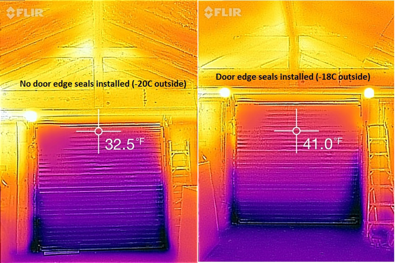

I sourced some extra brush seals today (45 degree, 2" long brush) to add to the inner side rails. Slight pressure forward (need to take some pics to explain why) will help air seal the system as www.smartgarage.ca "fills" the edge of each corrugation on the front with a small foam block. This means that the outside facing seal on both sides/edges of the roll up door is more or less straight, so will form a good air seal as long as the door is not "floating" in the side rail.

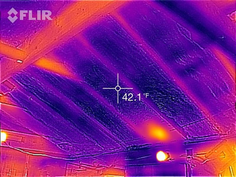

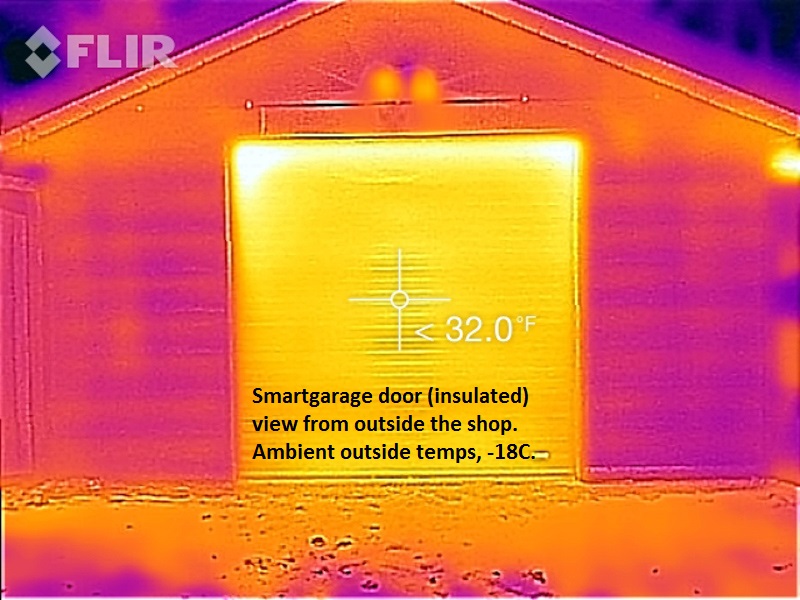

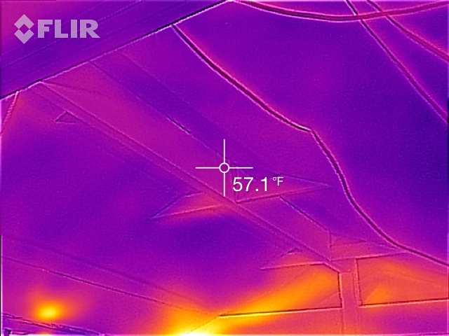

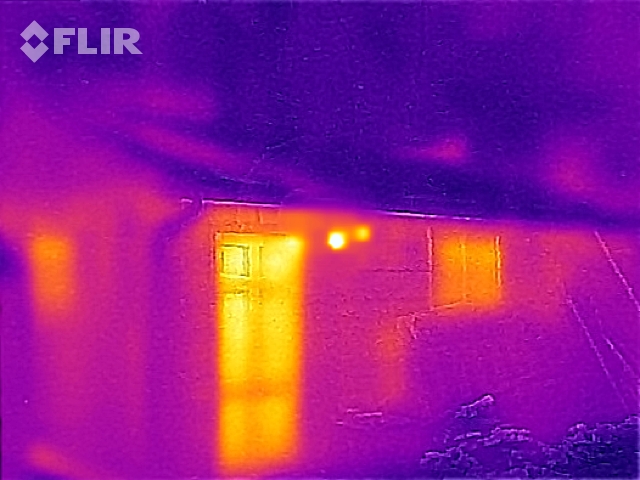

A few shots taken with a FLIR ONE thermal imager. Outside conditions, -20C, with a windchill at -24C (-11F)...brrr! The heat in the shop was on for about an hour, set at 15C (60F).
The roll up door, and spray foamed ceiling are shown. Note that the outside side "seals" for the roll up door are not installed yet. I'm using 2" nylon brush seals angled at 45 degrees, (not sent with the door) to improve the air sealing a bit from the outside..again, not installed yet. The drywall for the ceiling was delivered today so I figured I'd grab a few images before it's up.

Denwood: thanks for putting in that your -24 is actually -11 in my thinking. when you said your temps got below -35 I forgot you are on a different temperate measuring system than i'm used to here in the US. still cold as hell though and looks like you have almost eliminated heat loss. cool camera pictures by the way.
you are working on having the nicest 1 car garage I think I've ever seen. the cost to raise the ceiling was reasonable, but then you added the spray on insulation, new garage door and the lift. by the sounds of it you could have built a new garage on a vacant lot for less, but then you wouldn't have your cool neighbors and that old house i'm guessing that is spiffed up like you like it.

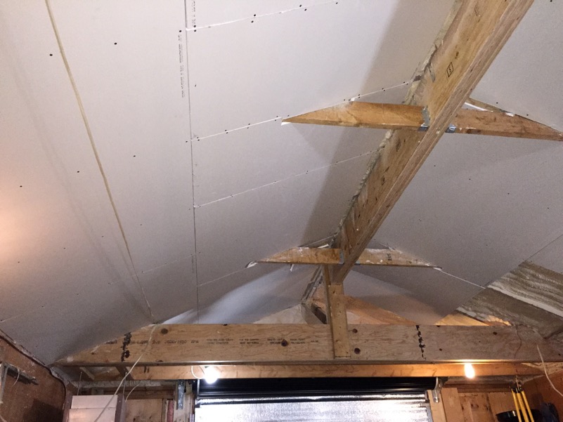

Next step is drywall for the ceiling (hopefully "Bob") will show up and finish the boarding/taping this week. All of my storage is moving to suspended high cabinets around the perimeter, and all of my tools/fasteners etc. are moving to a few added tool chests. It should be an efficient space once complete. This forum has certainly shaped its design :)

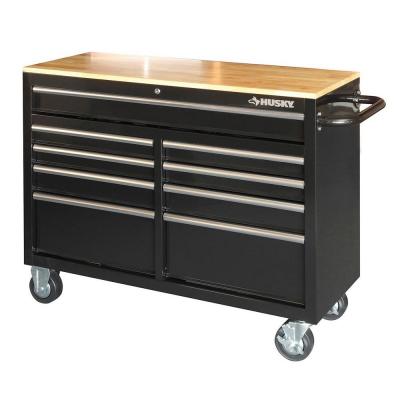

i started one corner of my shop i lease with this 8 foot butcher block top metal framed work bench and i found these 2 33 drawer metal cabinets that fit just barely inside the frame of the bench. it should work out well and i will either find another one identical for my house or take this one home. i'm not positive what the metal cabinet with all the drawers was originally made for, but mine held old TV parts so not any grease and only minor rust that i can live with.
I second the GJ influence because before i joined i had a couple carry tool boxes and a small 2 drawer tool box on top of my work bench. i can't tell you how many tools and tool boxes i own now, but i do have better tools for the jobs they were meant to do. looking forward to seeing how you manage your smallish garage's space.

Drive, I looked at butcher block for tops (the cheap stuff from Menards) as I think it makes a perfect work surface. Right now, I'm attempting to buy some 42" tool chests on a special buy (Home Depot) with hardwood tops for $299 each...a great price. Nothing in my shop will be stationary. Everything will be on wheels.

Drive, the boxes are great. The tops are hardwood and sealed so are an improvement over what they replace. The built in bench (pretty ghetto) on one side of the shop is gone now, replaced with the two toolbox/benches which have organized a lot of clutter and will provide 8ft of work surface 18" wide. They are easily moved and the castors included are just fine with a very loaded box. Any projects needing center workspace can be addressed with these. At the sides of the shop, my cutoff is 18" intrusion so car doors can open wide. A larger bench ( on wheels but made with Kee Klamps) will cover the rear of the shop as soon as all the high wall cabinets are done.

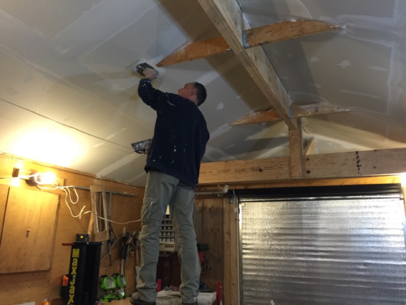

Bob the drywaller was not super happy over his progress in 8 hrs. This ceiling has a lot of cuts! Thanks Ryan for renaming this thread..." Woody's Works Garage". My ceiling project has evolved into a pretty comprehensive shop rebuild.

I had the heat on for an hour or so to do endwall framing for drywall tonight. Here's a few more FLIR images of the smartgarage.ca roll up door before and after side seal installation. You can see I've still got a bit of work to do non the right side to adjust the seal. Outside temps tonight were -18C.

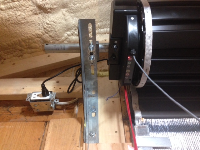

The roll up door operator is wired up, limits programmed, and working perfectly. After 14 yrs of manual hangar doors, the roll up with operator is pretty sweet :)

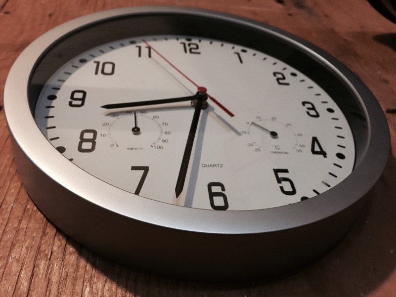

Two things I've never had in a shop before. A clock and an automated door :) The clock will get an interesting treatment "once the time comes". This one displays temp and humidity so perfect for painting.

Denwood: i didn't notice the name change on your thread. very appropriate for what the project turned into. did you ever take any pictures of your garage door from the outside and can you post them on your thread? or did i miss that post?
boy that is a lot of seams for the drywaller to tape. any idea how long it's going to take him to finish up drywall mudding and taping?
did your heat loss improve in the ceiling with the rock installed?

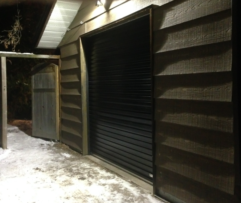

The roll up door from outside.

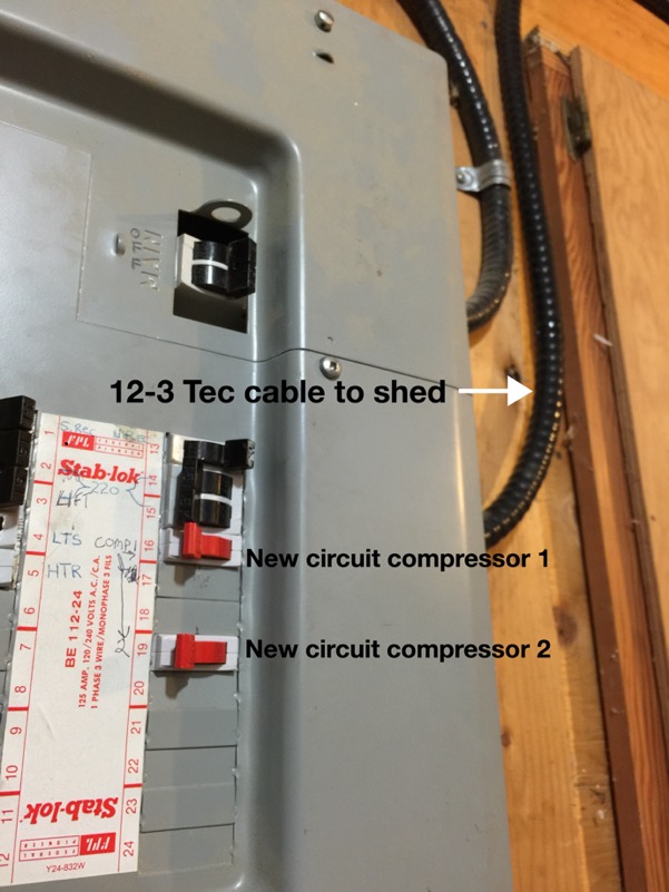

After quite a few references here I decided to free up more space again by moving the dual compressor setup to an existing shed. A few phone calls (this would be my first breaker panel mod) and a visit to a local electrical supplier cost me $130 for 12-3 Tec cable which will carry two 15 amp 110 circuits for each compressor. So from this:
To this:
Each compressor will be shut down when not in use via the panel:
There is something wrong with this setup. Can you figure it out? Keep in mind I'm using 12-3 to carry two circuits...the setup could cause a fire if left as is.

I worked for electrician way back in 1993 to 1995 during summers and remember just enough to be dangerous
And I've stayed at a holiday inn, it wasn't last night but still,
Ill take a stab and say your running two hots down the 12-3 one for each compressor but both compressor are sharing the same common back to the panel and that is wrong.
Along with sharing the same ground. Which is also wrong.
Each compressor should have its own 12-2 line from panel to compressor.

That's it. Actually the "Edison" circuit is fine as long as the hots are not on the same side of the panel. The reason is that equal load on the hot wires (providing they were connected to separate sides of the panel) would potentially see no current on the neutral, rather than stacking current. AC current in this case is your friend. I tested the compressors on the same phase (as pictured) to see if the shared neutral would even heat up. It didn't..but the compressors are not pulling 20 amps either. My brother is a licensed electrician (industrial)..so my setup is based on his recommendation.
The two 110V 20 amp breakers should be ganged together (once breaker 2 is properly relocated!) though so that the next owner doesn't get a nasty surprise if he/she decided to work on the shed wiring, shut off breaker 1, leaving breaker 2 of the shared neutral circuit on, and be hanging off the shared neutral for circuit 2 if a compressor fired up...

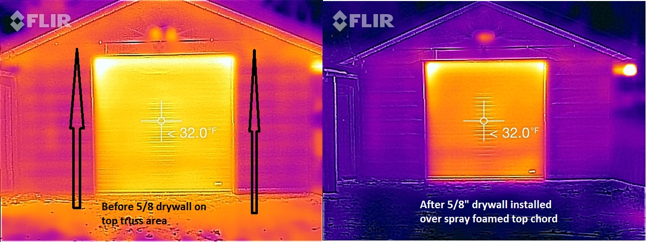

Drive, here are a few shots after the 5/8" ceiling drywall was added over the spray foam. You do see a definite increase in R value.
A view of the drywalled ceiling to compare:
This was the ceiling before 5/8" drywall, just sprayfoam:
Outside, with snow still on the roof. This is a good sign as excessive heat loss would have melted it, particularly with our current mild temps just around freezing:
