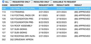

Still waiting for the inspector so they can start on the shingles...
And I have folks coming over the weekend to paint both the house and the workshop... Let's get it done!!
W
wachuko
May 15, 2008
691
Ocala, FL
Inspectors came in half an hour ago... all is good. Inspection passed. I also got the green light to paint it all... The only pending inspection now is the final one.
The crew will continue the work tomorrow. If they get the two garage doors early Friday, they will install them... but they pretty much doubt they will get here in time. They are still expecting to have it all finished and wrapped, for final inspection, on Monday.
