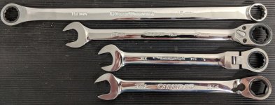

Snap-On ring size is almost the exact same size as most of the offerings out of Taiwan from Kabo and Hi-Five. The heads longer though so you lose a little swing arc with the Snap-On if the fastener is next to an obstruction.
You could look at GW 120XP or Carlyle.

Here are some comparison photos. Notice the Snap-on ring is smaller by a significant margin. Also note that it extends farther and has a more aggressive offset. In the last photo the Snap-on is on the left and the Carlye is on the right. The beam is also slightly thinner.
