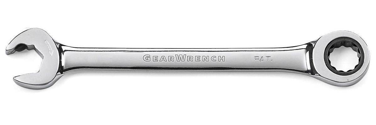

Like this I think.
<iframe width="560" height="315" src="https://www.youtube.com/embed/ru2gTbrlyBs" frameborder="0" allow="accelerometer; autoplay; encrypted-media; gyroscope; picture-in-picture" allowfullscreen></iframe>
Gearwrench also make one similar.
