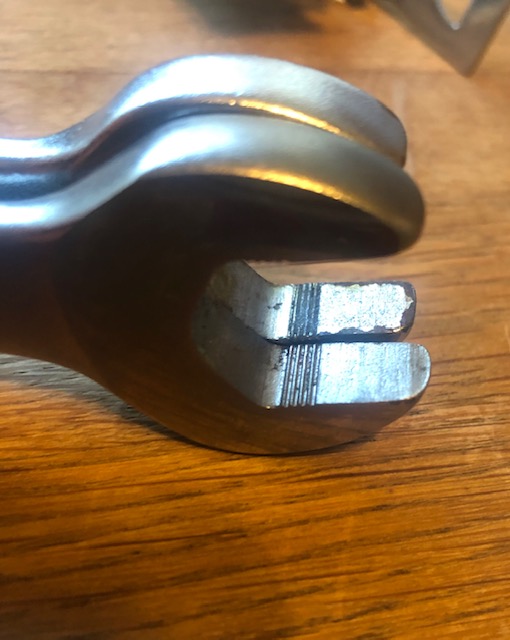

I have the 1.0 sets and added a few of the 2.0 wrenches for additional sizes. On my wrenches, the difference is the teeth on the open end are more aggressive (ie deeper) on the 2.0 wrenches. If you just look at them you hardly notice the difference until you run your fingers across the teeth.

So did anyone figure out what the actual differnce(s) are between the 1.0 and 2.0 wrenches?
Here is a picture of a 2.0 in front of the older version. The teeth are slightly more aggressive. These are both 11/16" wrenches.
I hate these wrenches. My work bought me a set of these and I kept some of the smaller wrenches and gave all the larger ones away. They are so heavy and bulky.
vm-F7MC0vKzigqe138jR2NkMhkwLccD-pCcRJNA9whCNCbxZ4nxEwpb6J_3IreIdlJH4vOZpsD92fzB2GVygVChSpKNmUImcgRVFf2aREutSEllbVtDa_Z0waVTxoQhnZl0eqMWwOvHU4UNfaEnlBnBlb1myB-6DjSBH-OvRudnTB8v86zHsdKE0yuyIwsDfc06uK7ERBhnbX4hOUVcE_g1H-9DlZCCfE1f5wz38ZPblZC7MOwDGkYZRHX49ea15iDWJoJ3f9c_xFvdkaE8VOGcOr_w7TJkgYDcWSGica_5YdiG0gTN7eh4VS6KEyubb9WBOA6BlbIT-43KndcN0sbU76VaBqat205tExEsMP7ASxrGWwlu6OJbv4qEyFlKNsKf_vvp932IgdzEhMjicTVSpnRNFNbWbIewUJWhXTVMbbroXWFDbERGpx1XdB8024qV8cLf-PiO2MKceDFxnJUxTaWQ-IUqpu09PmYXZMCMFauaLh5ulZ31RtJAZKjqPaFnvLt33RLG_57JEP8xX_kDRtSdeZoNhyC0dD1U2ynWZe-S5i43mWCkn0RNaNw9itiO2ITpgSffbooByMI3Q2DjLbCeSfqBHk2V_v2fN-Q4OPI7iat30OdtuWQ7_pGITBAaNOdDmc0Oqm2vAZTnkuAA=w510-h640-no
PretendMechanic
Aug 1, 2017
161
USA
So 2.0 would slip less? All this talk about 2.0 marring less is false then? Are you sure the "less aggressive" teeth on your older 1.0 set isn't just from wear since you've added the 2.0s recently?
Picture no worky? Try again?
Was the 2.0 or 1.0 the one with more aggressive teeth?
Do you hate the 1.0 or 2.0 specifically or all of them in general? Only reason the bulk?

Sorry, here you go. Yeah, I just don't like the wrench in general - I never did. That's just my personal preference.
Very helpful, thank you. :beer:
I've decided to go with the 2.0 set and pass on the NOS 1.0.
Too bad you didn't like them, I have handled both and they are the best finished wrenches I have ever handled. Light years ahead of Proto.
