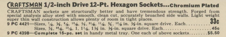

Craftsman (1941) (note: no 25/32")
I'm just trying to give you a quick coarse sense of what was available. As you can see, most of the odder sizes routinely found in sets in the 1920's and 1930's have been dropped.

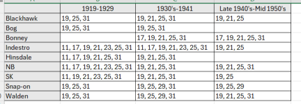

For brevity, skimming over all kinds of details, what is at work here is the confluence of two different trends. In the US, the boltage fastening industry, including the automotive sector, was moving from U.S.S., A.L.A.M., Am. Std. and the newly emerging S.A.E., to standardizing around S.A.E., from the turn of the century to WWII. At the same time, the hand tools industry was moving from fixed (forged, welded, or press-fit) socket wrenches to detachable socket wrenches, and within the detachable milieu, from pressed steel or malleable iron to cold forged and machined, hot forged and cold broached, and eventually, hot forged and hot broached.
Mossberg and similar socket sets went from 15/32" to 1-9/32" - without missing a /32nd! But they are crudely sized for tolerance in a wide range of low quality hardware, made of pressed-steel, in the 1903-1919 era, and will not really suit any of your practical modern needs.

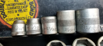

Pre-Craftsman Hinsdale-made Sears, Roebuck & Co 11/32, 17/32, 21/32, 25/32, and 31/32.

...to test my self-educated postulation hunch, that it will need to be a mix of sockets across compositions, styles, and decades. I won't argue with "most," but I am feeling like it might only be "many" from any one or two brands, and, closer to my point, if pressed-steel is out of the question, and as modern as possible is the goal, I think it will require something like this...
1920's/1930's Machined or Hot-Forged/Cold-Broached
13/32
17/32
23/32
27/32
1940's (or Later) Hot-Forged/Hot-Broached
19/32
21/32
25/32
29/32
31/32

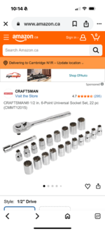

I did a quick search online and found this set on Amazon . I’m not sure if it has every 6 point 32” increment, but it might be what he’s looking for…

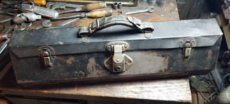

Doing some light scouring this morning did make me remember I had this New Britain set, marked only with MADE IN U.S.A. and sizes. Old enough to have a lot of the 32ds but new enough to be hot-forged, hot broached, chrome-vanadium composition, cad-plated, without being too bulky.
The plus was it didn't have a handle, just the metal strap, so I grabbed one from the salvage drawer and put it on for the photo! :pimpflash Been meaning to get around to that, so thanks. HAHA

Here’s my rail of /32” fractional sockets, have never used one from it but would have used examples from 1/4 drive sets.
31/32 being Chrome Nickel
29/32 is Snap-on from 1937
25/32 is #225 Chrome Nickel from Walden Worcester, 6 point.
25/32 is Stahlwille
21/32 is Stahlwille
19/32 is Stahlwille
13/32 is Stahlwille
Then dropping to 3/8 drive
19/32 is Britool
17/32 is Britool
15/32 is Britool
15/32 is unknown 1/4 drive 6 point
9/32 is Walter 6 3/8 drive 6 point.IMG_0205.jpegIMG_0206.jpeg
