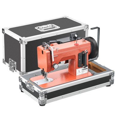

Although it came with a seat and seat back, a bit of research revealed they were not correct for a ‘28 RPU. They fit, but attachment points were wrong. So I bought a walking foot sewing machine, watched a bunch of videos, did a bunch of practice sewing, and built myself an interior.IMG_2189.jpegIMG_1194.jpeg

It wasn’t that long. I bought the sewing machine about two years before I did the upholstery, and stitched up a cover for my metal lathe out of Cordura material. Then I sewed a sleeve to store my cutting mat in. Then I didn’t use the machine for about two years. Around September before I did the interior, I bought foam and marine vinyl to make a new seat cushion for our tired old golf cart as practice for doing my Model A. The golf cart project was done over about a week. It gave me confidence that I could do a presentable job for my ”A,” but I knew worst case I’d only be out my time and the cost of the materials if I screwed up. It was also an opportunity for me to try out different stiffnesses of foam for my project. The Model A Seat is done just like the golf cart- nothing more than an appropriate foam shaped with an electric knife, covered in marine vinyl that was first stitched to scrim foam, then stapled to a plywood backer. Of course, before I tackled the real pieces, I experimented with stitching together smaller pieces with cording, different types of seams, etc. I think I did all the Model A pieces over about a 3 week period, working at a comfortable pace. (I’m retired, so comfortable= no hurry, have fun, walk away if frustrated.)

Would you be willing to share the sewing machine model that you used for this project?
Sure- it’s the basic Sailrite machine, with the option of servo motor drive and speed reduction flywheel. You can see it on my bench in the photo of the upholstery.
