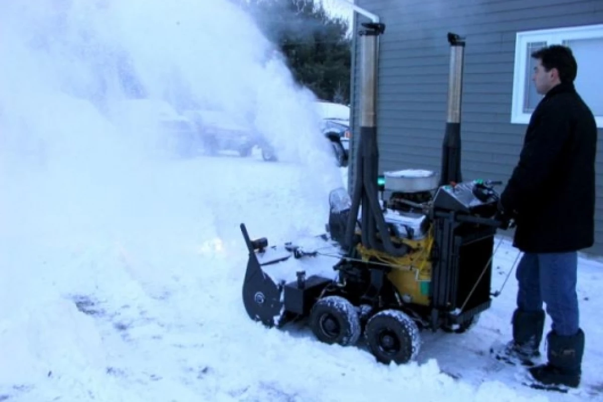

Man I got all excited about the v8 snow machine. After seeing some of Mike's projects I can imagine what a work of art he could whip up. Tig welded powder coated frame, custom paint and so on. The roar of an open header v8 at full song at 4 am?

Justin, that reminds me of the mower Randy Quaid runs in the Richard Pryor movie Moving.

My dad lives in Idaho and both blows and plows with the same quad. We set up the blade to hook up the same way as the blower so he can swap attachments in about 10-15 minutes by himself with no lifting. He got cold so we fabbed a cab up for it. Then recently he didn't like the crosswind so he sent me dimensions and I made a side curtain to snap in. He rides side saddle since it too hard to climb over the seat all the time for an old guy so one side boxed in works good enough. He plows almost a 1/2 mile driveway for 3 houses up on a hill.
