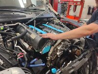

It was my son and DIL's 5th anniversary on Friday so we didn't work in the shop but he came over on Saturday with the goal of getting it sitting in the engine bay bolted in place by afternoon so they could go and enjoy an anniversary dinner.
We fought the engine alignment a bit but ultimately we won out.
Grabbed the flywheel holding tool that I've had for several decades. I've held a lot of flywheels with this old tool.
Once we slung the engine and got it off the engine stand I proceeded by torquing the flexplate to spec.
Flexplate installed.
Next it was time to finish the balancer install by torquing the crank bolt to spec and holding the flywheel.
Lastly I slipped the steel separator plate in behind the flexplate and engaged it on the dowel pins as well as added a bit of anti-seize to the dowels. When we pulled the OEM engine, one of the dowels was seized in the transmission so this should prevent that from happening.
One last glance over the engine bay to ensure it is ready to receive the engine.
Front tires/wheels removed and front end lowered to clear the radiator support.
Slowly going into position while we confirm there are no interferences.
And after a break for lunch we had it in place, bolted and ready to start the final connections and assembly.
Front tires/wheels reinstalled and this is where we quit for the afternoon.
Thanks for looking.

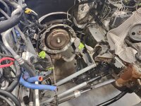

Last night we were able to get the remainder of the bellhousing bolts installed/tightened as well as the torque converter bolted up to the flexplate, the crank sensor installed, the support bracket between the engine and transmission installed and then moved topside to snake the grounds down through the motor mounts and into position. However, upon looking at the split loom on the grounds neither my son nor I were happy with how they looked. Granted, they are 20-years old and have held up thus far but we wanted to replace them before connecting and put it back as close to OEM as possible, for a 20+ year old Jeep anyways.
On the passenger side, the battery ground cable split loom was crumbling nearly all the way up to the battery. We were able to remove it and break the sticker away from the split loom enough to slide new split loom under the OEM part number sticker. Although not necessary to keep the OEM sticker, it sure felt good to have it put back to OEM level and keep it on the cable. We then tuck the cable down behind the motor mount exactly how it was run from the factory and let it hang underneath along with a couple other grounds.
Moving over to the driver's side, we also noted some severe crumbling of the split loom so we addressed it as well. This is a loom containing the oil pressure sensor wiring and connector, the bank 1 upstream O2 sensor wiring and connector as well as another ground which gets bolted to the block. While we were replacing the split loom, we cut the tree barb free from the OEM loom to reuse as well as the strain relief connector that attaches to the stud on one of the rocker cover bolts so everything looks as OEM as possible.
Wire routed behind the motor mount and ready to go underneath and connect. While we were right there, we installed the oil pressure switch and connected it as well as connected the strain relief onto the rocker cover stud.
The only things we have remaining underneath is to connect these grounds, install the starter motor and then connect the exhaust downpipes to the manifolds and we are finished with the underside and can move topside.
Thanks for looking.
