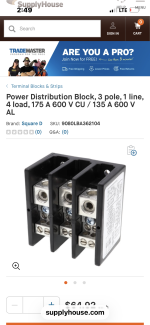

So I have a question for the electronicticians of the bunch.
I have been collecting parts and pieces to begin work on my car trailer and I am planning on mounting my battery under the deck and having a junction block or box in which to run a battery cable to, then branch off of that junction block to the hydraulic pump as well as the winch. What have you guys used that is a good quality junction block that can handle upwards of a few hundred amps yet be somewhat weather protected? Probably not 100% weather sealed, but enough to keep road spray and debris off of the actual terminals.
Any links or suggestions would be greatly appreciated. I have used a few standard junction blocks on various RV's, but they are usually in a compartment or an area not in direct contact with road spray.
I've been looking at some from various generic sites by searching images and nothing is really exciting me. I would like to hear from the group of what you've had good results with.
Thank you.

Mike google car audio distribution block or car audio fuse blocks. I haven't played around with that stuff in years but they make all shapes and sizes and most have a plastic cover. There were some that had rubber seals where the wires went in if I remember right. I have a few boxes of amplifier power wires and distribution blocks somewhere but buried in bins and no clue what where.
Maybe something like this if that's what you're thinking, https://www.waytekwire.com/product/...LVbJen9xTOMX9jF7U4tleUQbJQqrwSEMaAo0jEALw_wcB
Another option that I've done with a dump trailer before is a weatherproof junction box and you can mount any distribution setup you want in it. I used a bigger one and drilled the holes I needed and used grommets for the wires. Had the trailer harness coming from truck ran into it and then wires out to lights and battery.

Mike, they make power distribution blocks in all kinds of configurations. And it’s be easy enough to seal it. What size wire and or stud size do you want. I’ve got a hell of a collection of these and if one suites your needs, it’s yours bud.
Thanks Cam, I very much appreciate the offer. I use those quite extensively in the industrial field, but my experience has been similar to Thom's when it comes to refitting the cables/wiring after the initial installation. I'm looking for more of something with a stud or studs so I can use lugs on the cables. To keep it clean and simple was just planning on using a single isolated stud for positive and another for negative and land multiple lug ends on the studs, but just not finding what I'm looking for to seal it up after the connection is made. :headscrat

I appreciate everyone's input on the electrical components I was inquiring about.
I was able to find pretty much what I was looking for, although not exactly. Maybe exactly what I'm looking for doesn't exist and I was just being overly optimistic that I'd find them.
While I was able to find a buss style of sealed housing, it wasn't rated for high enough amperage so I ended up ordering a couple of single stud style junction blocks in which to connect the battery cable to, then two branches, one to each the hydraulic pump and one to the winch by using two single Eaton/Bussman AMG/Mega fuse blocks with lids that appear to be "somewhat" weather protected, although not what I could call weatherproof, but better than nothing.
I was also able to order some 4/0 to 3/8" lugs and a couple of posts to use as remote connection points in the event a battery failure.
Once the order arrives I think I will have everything needed to pull the trailer into the shop and begin some mods. With not knowing the exact length of 4/0 cable needed, I will have to order that once I get an amount figured out or will source it locally if possible.
Again, I appreciate the input from all of you it was very helpful.

It might be a decent gambit to replace the ugly gob of clear silicone with water-tight cord grips in the side of something like a Tuperware or a waterproof project box as a means of water-proofing an isolated stud or bussbar.
Thom, Thom, Thom, have you not paid attention to my thread at all? Do you think I could strap a Tupperware box under one of my vehicles? :bounce:
Waterproof project box.
You can buy project boxes from Mouser and DigiKey, as an example.
Hell yeah, that is what I was looking for. They had a nice smaller sized one that should work perfectly to house a junction block.
Thank you.
