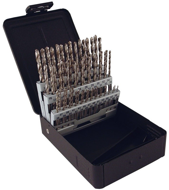

For the money the Made in USA sets from Enco seem to be the best deal. They have a nice set that has 1-60 AWG, A-Z, and 1/16-1/2 by 64ths for a bit over $100. They come in a nice metal drill index. I've used this set for several years and I'm very happy with it. I have managed to break one bit but it was my fault not the bits. It's really nice to have those sizes that fall in between fractional drills all in one set. No affiliation, just a happy customer.

I recommend the 115 piece USA brand set from Enco. It's on sale right now for $129.95.
Enco Set
