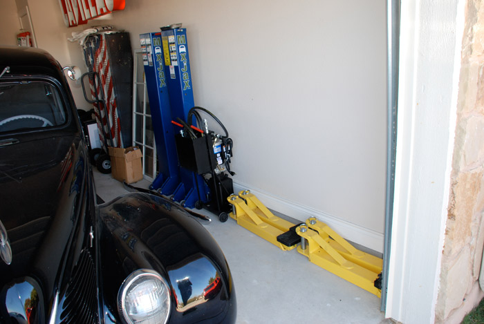

This is the glory shot... The only lift in the world that you can put away...

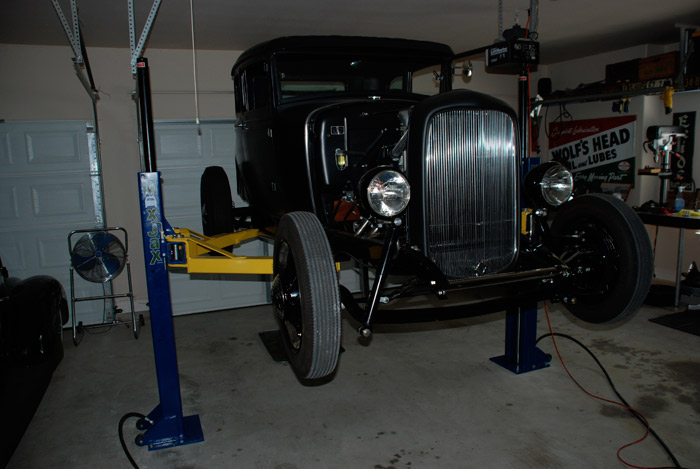

About a month later, I burnt up the clutch in my ’38 Ford coupe. This misfortune proved to be the perfect time to test out the MaxJax under real circumstances. Setting up the lift was easy. While it does take quite a bit longer than just grabbing a jack and jack stands, it’s not nearly as much effort as you might imagine. Once practiced, you can easily have your lift up and operational in under 20-minutes.
Once set up, it was time to situate and lift the ’38. I admit it… The first time I got the car up in the air I was a bit nervous. I mean, there’s my “baby” parked almost 4′ in the air and the only thing securing it from absolute devastation is five anchored concrete bolts. It just looks and seems precarious for a guy that isn’t use to using lifts. That said, the ’38 lifted smoothly and was steady as a rock on the lift arms.
And man, having a lift made the clutch install so much easier and more enjoyable. The 45″ lift height of the MaxJax is the perfect height for working under the car with a seat creeper. Removing the exhaust system, dissasembling all of the linkages, and all of the other light work went twice as fast as it normally does. The only problem I faced came when it was time to do the heavy lifting.
The MaxJax safety system is actually two bars that you slide into the posts through a series of holes. You simply lift the car to two preset locations on the lift posts and then insert these bars as a safety mechanism in case of hydraulic failure. The problem I had was that the location of these holes on the posts didn’t allow me to place the car at the exact height I really wanted it when it came time to take out my Muncie. At the top hole, the car was too high and the heavy ****** was awkward to lift. At the bottom hole, the car was too low to smoothly slide the ****** in and out. We solved the problem by breaking all kinds of international laws (I’m sure) and just lifted the car to the needed height while ignoring the safety bars for a few minutes.
All that being said, the MaxJax really did make my life easier. This system is not a replacement for your jack or jack stands like I had initially hoped. If you are just going to change the oil in your car, I don’t know that the effort of pulling the lift out and assembling it would be well spent. However, if you are going to be under your car for more than a few minutes – the MaxJax is damn hard to beat. It’s simple, small, and incredibly conventient for a completely operational lift.

. . Sure wish I had one... Unless it has a mattress label on it, could it be as easy as to drill some more holes at your desired hight for additional lock stops??
At the top hole, the car was too high and the heavy ****** was awkward to lift. At the bottom hole, the car was too low to smoothly slide the ****** in and out. We solved the problem by breaking all kinds of international laws (I’m sure) and just lifted the car to the needed height while ignoring the safety bars for a few minutes.....

I also have a 109" high ceiling. I was about to drill another set of hole in between the first and second set of holes as well, but I hesitated because want to make sure the warranty will not get void if I do so. Also. the new holes will hit the safety procedure and warning label. Time to call Danmar.
Would love to hear about what you think of the lift. Thoughts? Same as mine?

I do believe that I got cheated. The blue one has more safety labels on it than my black one. I want a refund or more labels............. :lol_hitti

This is by far,....the best tool I've ever bought. I can take out my engine and transmission out at my home rather than trailering it to my buddy's auto shop. Everything from major work to simple cleaning can be done with the MaxJax. I even have laid a sheet of plywood on the arms for a large work bench. All of this can be at a height that I'm comfortable at.

You know, it was my initial intention to move the MaxJax into place whenever I needed it. As it turns out, it isn't that obtrusive. So, I find that I will leave it in place and move it only when I have to. I even removed the wheels so that it could more easily fit within my modified floor tiles (1/2" thickness) that I cut out to accommodate the floor plate.
Same here. I "share" the garage with my wife's car. At the end of the day, her car needs to be inside on "her" side. I was planning on leaving just the outside column up and taking down the middle (shared) side column. As it works out, it's not a problem I just leave them both up at all times. Makes life a lot easier for me.
Here's another vote for more holes. I use my lift for working on the racecar. The first thing I do when working on it - with jackstands or the lift - is taking off the wheels. Right now I'm doing a head replacement on the car. If I was going to use the first hole I would have to use a step stool to reach into the engine compartment. What I did was set some jackstands up as backups and lower the car onto them while working over the fender. Would be nice if I could have another hole or two. One lower and one more in the middle.
That said, even this arrangement is great. I'd be working over the fender, walk over to the unit, pump it up to the next stop and pin it, get under the car,detach the starter, unpin it and lower it back down. With floor jacks and jackstands that's a PITA, with MaxJax, piece of cake. I'm loving mine.

I just cant get my head around this thing. Id really like one but I don't know if I have the nerve to get under a car that's on one. I just have a hard time trusting a few bolts glued into the cement to keep those things from pulling out and tipping inwards. Plus the rides I would use em for are my 41 and 56 Caddy's. Or my 71 K20 truck or my 69 C10 panel. All large and heavy. Gives me the willies just thinking about it.

I have the same scary feeling even after lifting a few cars a few times and even after leaving the car on the lift for 3 days with no incident. I had to wake up in the middle of the night to check if the car is still up in the air. It all comes down to the concrete quality and whether the bolts reached the req'd 100 ft-lbs of tightening torque with the top of anchor still below the concrete surface.
I am still scared to work underneath the car, to be honest. I had put a machine level on the column vertical surface to monitor the change in vertical plumb with the load. But so far, it's been holding up pretty good. I will be working under the car confidently probably in another month of testing. :)
Don't worry - one gets that feeling even with a 4-post. It's just holding a car up over your head that kicks in your flight-or-fight mechanism!!!:bounce:
