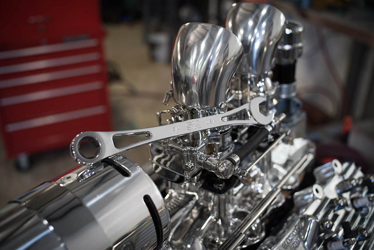

So, how have the SK wrenches done in our real world work environment?
Honestly, these are the best wrenches we’ve ever used… And I say that for a few  different reasons. First, is the swing. Remember that “6-pawl technology” mumbo jumbo? Well, whatever the hell that marketing refers to, works and works in a big way. These are absolutely the finest geared ratchets we have in the shop and this is huge when working on bolts in restricted areas and tight spaces.  Put plainly and simply, this feature alone is worth the cost of admission. No doubt.
Second, these are 6-point wrenches. I prefer 6-point wrenches because I just like the security of them, but at times they can be a pain the *** when trying to lock onto a bolt in a tight space. With the 1.7-degree swing this just isn’t an issue. It’s like have the best of both worlds.
Third, was something that kind of surprised me. Before I used the X-Frames I never really considered wrench balance all that much. I mean, I have a set of Snap-On open ends that feel really tactile in my hand and I love them. But these wrenches literally feel shaped for the hand. They just feel good.
And, it’s hard to argue against the look of the I-Beam. They are gorgeous if only for a  little while… as ours will be beat to **** in no time I’m sure. BUT, given that these are made in the USA and given the build quality that is obvious when you use them, I’m fairly confident that these are going to be in the tool box for a longtime to come.
