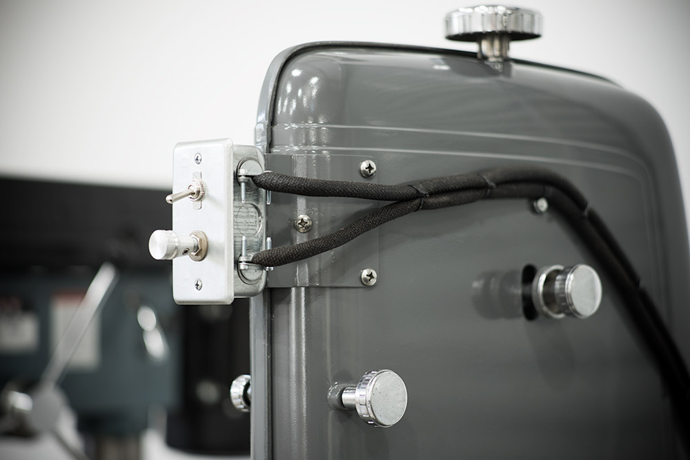

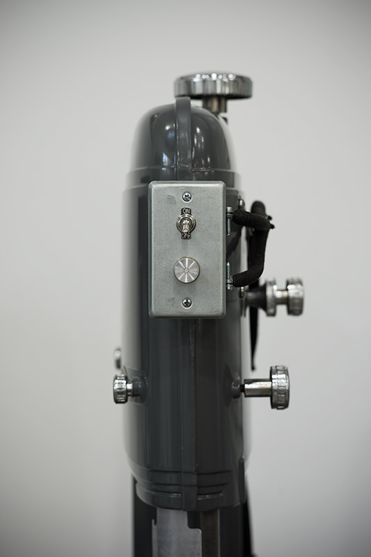

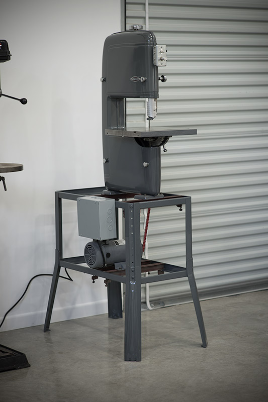

A few weeks ago, I found a beautifully restored Craftsman Bandsaw (103.24280) on Craig’s List. I called the guy and when I went to pick it up, I was greeted by a collection of gorgeous old wood working tools – all restored and all being used. I was mesmerized and taken aback by just how cool this old stuff is. The hook had taken hold… and I’m now fully and completely obsessed.
Anyway, I bought the bandsaw knowing that I was going to need to find away to slow it down in order to use  it for light duty metal work. My initial plan was to just go with a smaller pulley  on the original Craftsman motor and a larger pulley on the bandsaw itself, but I quickly figured out that a simple pulley change wouldn’t get me slow enough. I then considered using a jack shaft setup with multiple pulleys, but I wasn’t sure I would like the aesthetics of such a setup. I scrapped that idea when I finally got enough confidence to consider a DC motor conversion.

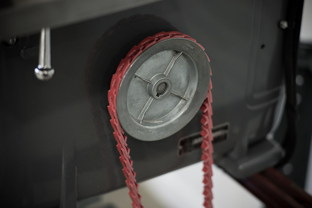

The advantage of switching to a DC motor is obvious – using a speed control unit, I could control the speed of the bandsaw almost infinitely – from a couple of RPM all the way up to 1800 RPM with a simple twist of the knob. This gives me the versatility to cut everything from steel to aluminum to wood without messing with pulleys at all.

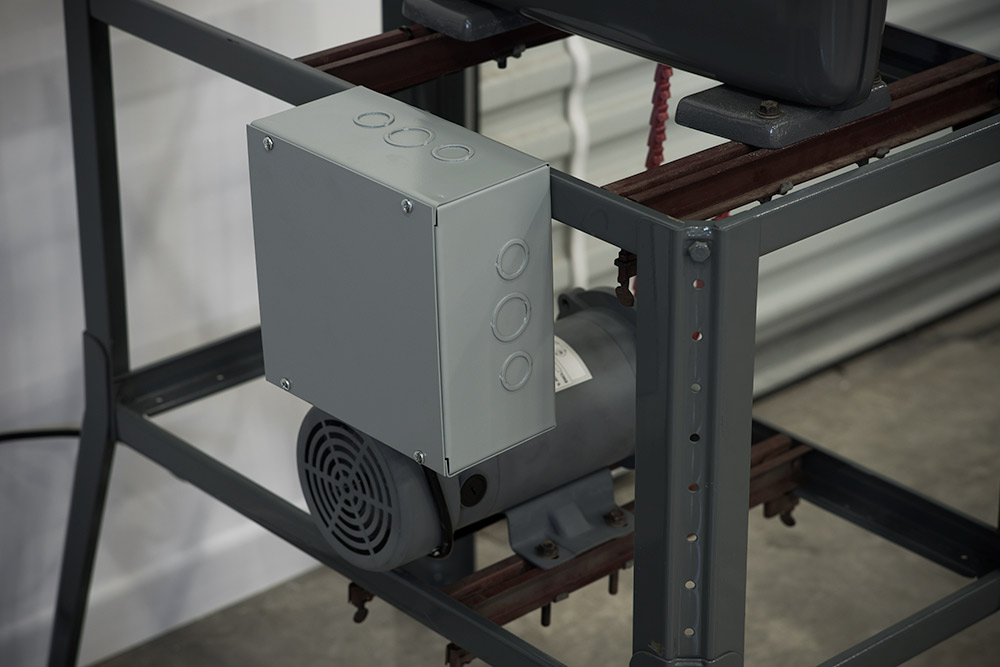

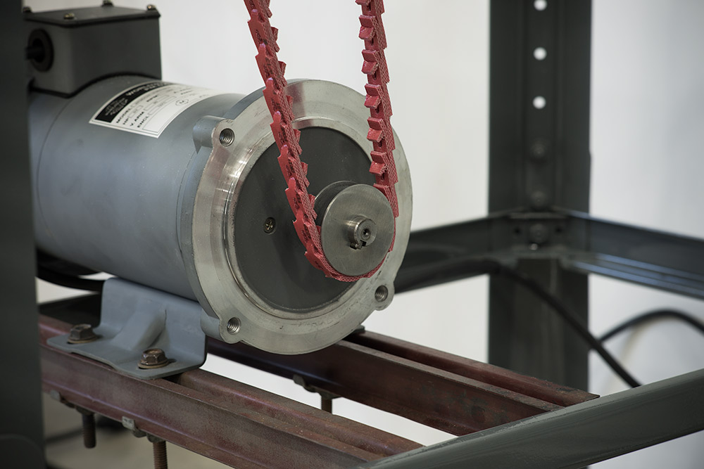

I started by getting on eBay and buying a used treadmill motor for $35. Once it got here, a quick test proved that it was burnt. So again, I got on eBay and bought yet another treadmill motor. This one ran, but not well and seemed to lose torque at lower RPM. Out of frustration, I got on Surpluscenter.com and ordered a brand spanking new 3/4 HP DC motor. It was expensive, but I knew it worked… and, it actually looked a whole lot better than the old treadmill motors that I was messing with.
While I was ordering, I also picked up a speed controller. This intimidating looking electrical device simply pulses the current to the motor allowing you to control how fast it spins. Essentially, it’s the brains of the operation.
Once it was all here, I quickly mocked it up just to see if I could get it to work without blowing up my shop. My first test went swimmingly and out of excitement, I decided to film my second for this very write up. Check it out:
**** like this happens to me all the time… Seriously… You could film a sitcom in my shop and probably get pretty respectable ratings.
Anyway, what happened?

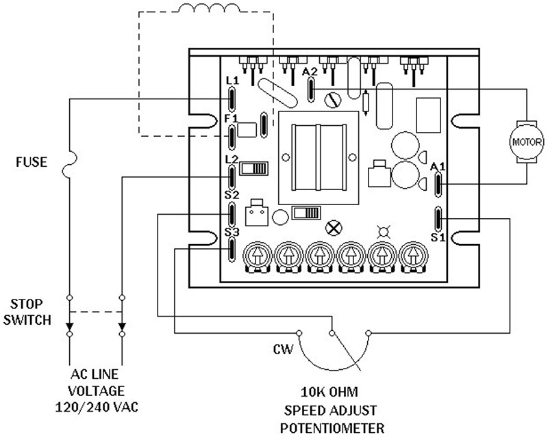

Before we get to that, it might  be a good idea to show you how this thing is wired. It’s a very simple chore.
The diagram above (click to make it larger) is all that comes with the speed control when you buy it.  Seems simple enough, right? I was confident that I had it all setup correctly, but I am also an absolute electrical flunky, so I headed to The Garage Journal forums to ask what might be the issue. Before long, I was pointed to the Minarik website (the manufacturer of the speed control) and their more complete directions found here. As it turns out, if you are sending more than 5 continuous amps to the motor, the speed control needs the optional heat sink. Well, I’m sending 7… so, the mystery was solved.
(Editor’s Note: I should also interject here – the more complete directions also give you a lot of helpful hints on how to  calibrate the control to the motor. Before calibration, my motor noticeably pulsed at lower speeds. Adjusting both the torque and the IR Comp solved this issue)
I then went and ordered the heat sink from SurplusCenter.com,  along with a new speed control to replaced the fried unit,  and waited for them to arrive. Once they did, my plans were foiled again. I had planned on hiding the speed control in a double gang box mounted high on the bandsaw, but the heat sink was quite a bit larger than I expected and there was no way it would fit elegantly in my planned box. So, I went to Home Depot  and got an 8″ by 8″ unit and just mounted it on the side of the bandsaw base. It’s not as pretty as I’d like, but it works… and with the hidden knock-outs relieved, I think the speed control and heat sink are both  getting plenty of air circulation.

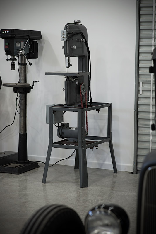

In any case, the project is now complete and the bandsaw is up and running really well. I’m still waiting on a couple of bimetal blades so that I can demonstrate metal cutting,  but I’ve ran some really hard wood through the machine at it’s lowest speed setting and it didn’t even hint at bogging. I don’t think light metal work is going to be an issue at all, but I will post some video as soon as I get the appropriate blades.
Enjoy the decent photos and the terrible video (updates to come):

Hey Ryan, You did a great job on the DC conversion and as you said the guy who restored it did top end work. By now I'm sure you know that a lot of us here are old machines guys and also members over at OWWM.ORG and VintageMachines.ORG. I got here by following Dave (RED LEADER) to see his 1950s Craftsman Garage retro remodel. It's great to see "the boss" getting into the same thing!
