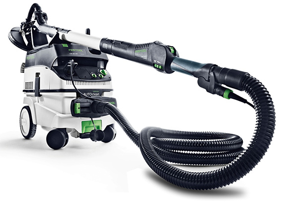

Festool Dust Extractor
Ok fellas… My decade old Craftsman shop vac is on its last leg and it’s time to go a new. Typically, I’d just buy another cheap Craftsman and call it a day. Not that Craftsman is the best bang for the buck vac (or maybe it is), but it’s just not a purchase I want to spend hours researching. But… But… I’ve kind of always wanted a Festool Dust Extractor. Specifically, the Festool CT36.
So, this post is a call out to any of you that own them. Is this thing really worth the $700 asking price? Is it THAT nice? I have limited experience with Festool, but that experience does tell me that Festool makes incredible products that often break the rules of common thought. But a vacuum is a vacuum, right?
Talk me in or out of it.

I have the ct36ac and Planex, which are actually what's pictured in the op. For sanding drywall, it is second to none. Variable speed, variable auction, auto on off, auto clean filter so you never loose suction, etc etc
