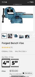

The Fireball vise I was recommending to @dallastide is this one. https://fireballtool.com/products/forged-bench-vise
I don’t have personal experience with it, but it gets good reviews (search YouTube) and is similar to the Capri Tools vise I have and like a lot.
Tough to beat this kind of deal on a new, quality vise I think.
Definitely, for general workshop use it's hard to beat that vise. Even has adjustable guides.
Seems like it is a Taiwan version of the German Peddinghaus/Ridgid vise (Matador). I think the Peddinghause may have more complex forging procedures so it is assembled from fewer parts (on the Fireball one it looks like it has a few more welds - I know the Ridgid is also welded together but they seem to grind the welds so they aren't visible as much).
My favourite is still Heuer for being forged in a single piece, the only welded part is the protective cover for the spindle which is not a load-bearing part.
I am certain the Ridgid/Peddinghause and even the Fireball designs are just as reliable. I just admire the single-piece forging more.
On the original Ridgid, the nut is also replaceable which is neat. On the Heuer it is part of the housing. Stripping the Heuer nut is not very likely, but in the even that it happened, the replacement would not be as easy (easiest way would probably be to drill out the old thread, buy an ACME nut and equivelant threaded rod, somehow fit the handle-head on the end of the threaded rod, tighten the vise together with the rod and the nut on the other side, then weld the nut on the back of the Heuer housing so it stays there).
