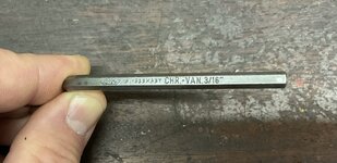

Growing up, I never had my own hex keys, I just used Dad’s. I don’t think he was bothered about the manufacturer, certainly not the way he would have been about a wrench or screwdriver.
I notice though, that they were all British made, and to the relevant British Standard. That’s important, and was even more so then. Some people will tell you that you’re a “country of origin snob” if you’re bothered about this, and anything can be made to the same standard anywhere. Well, that’s not the case now, and certainly wasn’t then. But If it was British made, it was going to be acceptable.
Many of Dad’s hex keys were “Unbrako”. I only realise now, after the passage of many years, how good these tools were. Even heavily used ones show little wear. I still acquire these if I see them used, and have a drawer full of miscellaneous sizes. Sadly, back then even long series were rare, and ball hex unknown, so I seldom find these.
When I came to buy some hex keys for myself, my first need was some small keys to leave by my machines. I bought some “CK” (Carl Kammerling) which is actually a British brand, although many if their tools are made in Germany. The same principle applies. I don’t even know the actual maker of these, but “Made in W.Germany” was all I needed to know.
And I was right. These little keys have had the finish worn off through use, yet still the tips remain good. Quite an advert. I’d have bought a few more sets if I’d known…!

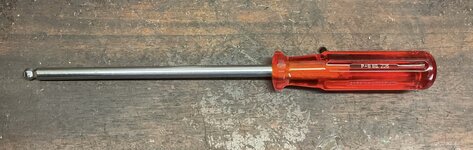

P.B. Baumann / PB Swiss.
About that time, I bought a set of ball hex drivers, used, from a local shop. They were from the, then unknown, manufacturer - P.B.Baumann.
These drivers were typically Swiss (something about the style and finish you get to recognise) and obviously of the highest quality, but I only realised how good with use. I used these drivers an awful lot, and they just didn’t show any wear, I couldn’t believe it.
I eventually found their U.K. importer and started buying their regular hex keys. The difference in quality between these and anything else was considerable. They were stronger, better fitting, better finished, and seemed almost not to wear.
I’d use one key of my own for assembly work in preference to the boxes of mid grade keys I was supplied and I was never let down.
I’ve heard people on this forum describe PB Swiss as a “boutique brand”, obviously thinking that their selling point is their coloured keys, or suchlike.
To do so is to totally misunderstand the product. For a start, they’re not a “brand” they’re a manufacturer - a distinction lost on many.
Their selling point is their quality - evident on close examination, or prolonged use, but they are much more.
Max Baumann, the “big cheese” at PB, told me that they carried out extensive research to find what their customers wanted.
One of the things their customers didn’t want was bent keys - so a PB key will deform elastically to it’s limit, and spring back to it’s original shape. Bent beyond that, it will break, but it won’t deform!
PB keys are also designed to flex by a comparable amount when they reach the limiting torque for a typical fastener. When you get used to using them in assembly you find this is true, and I can assemble 4mm x 0.7 cap screws with a PB hex key just as accurately (probably more so) than some monkey with a torque screwdriver.
Their biggest strength though, is their ability to withstand high repetitive loads. I once had an assembly task that involved inserting button head screws. That had to be torqued up quite tight, but couldn’t be accessed by a regular driver, it had to be a ball tip.
We were eating through Wera bits at a shocking rate, and Wiha drivers did little better. We switched to PB and completed the job (hundreds of units) with no further breakages. They are that good.
So, PB Swiss are best for overall quality (and finish) but also very good for the quality of their fit, and the selection available.
They offer short or long keys, standard or ball ended, and I think were the first to offer both the coloured keys, and the short / 100 degree offset.
Somebody will no doubt point out that in some numpty’s hex key test they didn’t take any more of an overload than the next best. Well, firstly they’re not designed to, and secondly, I couldn’t care less - that’s not how I use my tools.

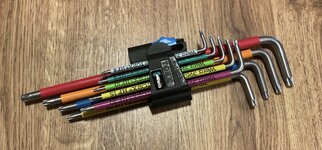

I’d also been monitoring Wera. Their outsourcing, primarily to the Czech Republic, was handled much better, and right from the start all the Czech made tools used first class steel.
I started seeing their hex keys more and more, and acquired a few despite not really needing more hex keys.
I was pleasantly surprised. Firstly, their (at the time) unique profile isn’t a gimmick - it really does work (though not quite the way Wera say in their advertising).
I got my first set of these for use on screws with damaged heads, but found that the profile works so well it actually avoids damage if you have to deal with soft screws. I really can’t recommend these too highly.
Other things I like
- The quality of the steel and the overall hardness of the tools.
- The fact that, on any but the most inexpensive tools, you actually get an oversized round shank key - something you pay a lot more for from PB Swiss. This gives the tools a very substantial feel. A lot of “heft”
- The variety on offer, particularly the selection in Torx and Stainless steel.
- The subtle variations - for example, the steel Torx keys feature a ball tip, the stainless a straight one. Subtle, but needed, and shows thought about details.
- The price. This side of the pond these are mid price tools. Even if they were not, I’d own at least some.
So, I think Wera are the absolute best for use on damaged screws, and for stainless tools. I think they’re best for Torx too.
They’re good for their selection on offer, durability, and availability.

I’ve got probably a “sizeable bookcase“ of entirely Unbrako. About 70% are BSW / BSF sizes, so incredibly useful to me now.
The non Unbrako all seems to be from the same era however, and seems comparable quality. A lot of Holo-Krome and GKN, and a lot of Swedish stuff. The latter is superb.

I use PB Swiss knurled L keys every day professionally, and while they are the best ones I've used in general, I do have one pet peeve: the ball will break off of the 1.5mm key specifically, with very little torque applied. Had this happen several times when snugging down small set screws.
The taper between ball and shaft (lol) is just a little too narrow I think.
Aside from the 1.5's ball end, the rest have held up to years of daily use with no discernible wear.
The Wera hex bit sockets have the same problem. They have the ball, which works great for holding fasteners, but the smaller sizes (I want to say maybe <6mm?) will shear off around the rated torque of a grade 12.9 cap screw. The larger sizes were fine. We used to have a few extras of the smaller ones because they broke so often.
It's a shame too, because the hex-plus bits were the best we found for not stripping out the fasteners. The Wera hex keys on the other hand didn't have the ball detent, and were fine. We straight up abused those things with all kinds of cheaters or pipes without issue. Great tools.

Those German-made Magic Ring keys are well crafted!
Another showing retention:
Also of interest, the large 950 series Wera (17mm shown) are made completely different than the smaller Wera keys. Lacking hex plus and having a high polish finish versus the satin finish of most others like the 950L (12mm shown).
