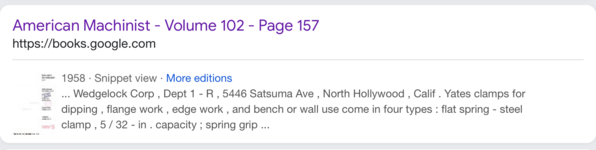

From a 1958 American Machinist
Yates clamps for dipping , flange work , edge work , and bench or wall use come in four types
Looks like Wedgelock May have been a maker or distributor.
Holding PCBs
Saw a reference to holding metal for dipping prior to painting, but don’t see it now.
Lots of references to prosthetic creation too.
Guy I got mine from said he used them for simple sheet metal alignment prior to screwing or pop riveting together

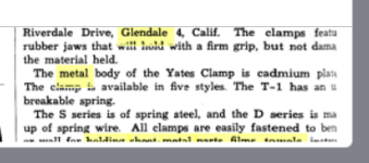

For those interested in the original intent - apparently Yates' overall objective ("small clamps for multiple uses") was as diverse as @MisterEd's intuitive reaction to them. (My 1948 source is Snippet View only, but if you're clever, you can compel Google Books to give you as many snippets as you can with search terms and stitch it together.)
The last line in the second snippet reads "for holding sheet metal parts, films, towels," (which took me several minutes of trial and error to get it to confirm my conjecture with yellow highlight...), but I can't read the rest of the line or predict enough of where it might be going to give me the next few lines in another snippet to see what other kinds of things/uses he envisioned
EDIT: Here's the rest! (Smarter than your average f&^%ing copyright limitation!)
"for holding sheet metal parts, films, towels, instructions, prints, display cards and many other items."
Although the unit in the photo looks slightly different than the units @MisterEd found.
Their TM (for the term 'SKIN-TITE') also mentions sheet metal.
