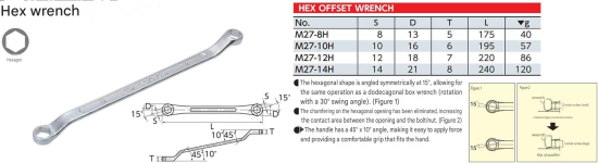

I sand away the chamfer on wrenches(when /if needed ) as they'll round a perfectly good nut/bolt thats tight just simply because the chamfer sees the wrench gripping only 1&2mm of the bolt head in some cases, like with my Tacoma seat belt bolt.
I was too lazy to go inside and get something else so tried to break it loose with the wrench set I kept in the car at the time, a set of KT pro, stupid stupid me. I now have a set of 1B's that I keep in my car as well now as the 12 point design is also better in addition to having no chamfer so no sanding required.
my SAE blackhawks needed the sanding treatment though.
Some companies list chamfer as a feature but I think it's just laziness in the finishing process. My opinion.
I looked for chamferless wrenches recently for that same problem on a bike, all I found were these KTC M27s. Photos here. Got them and they worked. Koken Zeal 1/4" sockets also had very little chamfer.
