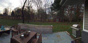

Lot layout and photos including Google Earth?
Zoning and zoning restrictions?
HOA requirements?
Easements, utilities and topography?
Bill
Zoning Im good to go. I can do a much bigger building but this size will suit me just fine. There power pole is in the back of the lot about 15ft to the right of the red shed. I plan on just running a line from the pole to the back corner of the garage. I do have a corner lot so I have a 45ft setback off the one side of the property. I had originally plan of having the garage on the hill but it involved get a variance with AA county and it was not worth it. My rear offset is 15ft off the back line. The main reason we got this house was the resto and the large lot.
I have no HOAs to deal with. My goal is to have something aesthetically pleasing to look at that would far exceed anything a HOA would. I dont want to be that guy in the neighborhood. All my boundary neighbors are on board with the building. After the previous owners we cant seem to do anything wrong.
The google earth shots are not up to date. When we bought this house there was wood up to about 50 ft off the back of the house. By woods I mean over growth and trees full of monkey vines. I had 1 year to clear it all out and put down 8000sqft of sod so we could have out wedding in our back yard. I was busy. A few months off at a time and anything is doable with a bobcat. The house was in pretty bad shape as the prior owners took care nothing. Crack den comes to mind, lol. But it is now one of the nicest houses in the neighborhood. It is def the nicest lot. Funny when people stop while driving by and tell you how much better it looks. Lots of sweat.:thumbup:
This is what the lot looked like when we bought the place.
Here is an up to date picture of the clearing so far. As you can see alot of the wooded area has been cleared and the 1.5 acres opened up alot. Sorry dont have a updated aerial shot.
