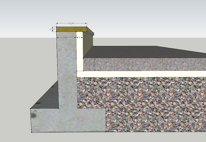

Update here.
Insulation is almost done, then the layout for the radiant heat needs to be drawn up.
Here is a picture of how we are isolating the slab.
I hope to see the floor pour in the next week or so.
