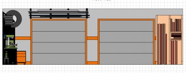

It looks like we are a go for a new garage! I am meeting our builder this weekend and passing him a check (two checks actually, one is for the City of Seattle permit office...) and I will have a real garage and wood-shop by spring. My too tiny, falling down, little carriage house will go away and I will have a new, modern, heated work area! Room for my big lathe, cabinet saws, wood storage, my joiners workbench, room to assemble projects/furniture, a real dust collection system for the first time ever, and all my planes/saws/chisels/hand tools on one side. On the other side of the shop will be a mini-machine/fabrication shop with a two post lift, lathe, end mill, welder, work table, and various other metal bit and bobs...
I cannot tell you how stoked I am! Seriously, I am all giddy about it. I plan to make cool stuff, build some furniture, descend into super-nerdiness, will go over my jeep with a microscope, and will be voiding the shiznit out of warranties! My wife is already planning on dinner in the shop one night a week - I do love her!
Here are pictures of my existing "garage," the prelim drawings that have been submitted for the new one, and a layout of the shop floor.

Looks like your new garage layout is missing a space for material storage... How high will the ceiling be, and will the roof trusses be designed for a usable storage attic?
...Also, does your dog know how much yard he/she is going to be losing soon? :lol:

Looks like you have alley access to your back yard. Certainly solves a lot of problems when you are building detached garage on a smaller lot. Going to be nice.

Subscribed. Your shop size is pretty much the exact size I'm going to be building as well. Looking forward to seeing how you organize.
What software did you use for that layout?

I wanted the 24'X30, but I had to sacrifice a foot to the Gods of Zoning. I used AutoCAD for the layout I sent to the City and for organization I used/am using VISIO
The north half of the Garage attic will have storage trusses and an extra wide pull down staircase for Christmas lights and **** that I am not allowed to throw away. The ceiling height on that side will be 9'. The southern half, above the lift, is designed with scissor trusses. It gives me 12'-1.3" after the 5/8 drywall is applied at the ridge. I will have lots of cabinet storage and space above the garage doors for steel and lumber, long lumber storage above the workbench and the lathe, and sheet good storage in the NE corner. See the drawings below, some of the storage is illustrated.
The dogs hate me over this already. They are not allowed in the back yard right now as the demo has started and stand at the gate and whine.

The only thing I notice on your layout drawing, is that I would make sure you have room to walk around the southern most post on the car hoist carrying a tire. Perhaps putting a shallow cabinet, overhead shelf, hose hooks, or something else next to that post instead of a bench would be a good idea? Just a little info from a person with one or two immovable car lifts. Shoot for a minimum of 24" to walk though

Thank you 54stube. I have the same advise from the machinist at my J-O-B. He recommends a tool board with shelf or cabinet above head-smacking height.
I will build my fab bench in place, so I have the room and flexibility to follow what seems to be sound advice.

I like how you have planned everything including the layout inside, of all your tools.
The saws I have recently gotten are just like the two you are parting with, so wish me luck.

Wow, I enjoyed looking at your sketch up of the garage and your planning of the locations of your tools. Very impressive. Richard D.
Thank you, Sir.
I have a little OCD issue with organization. I have spent countless hours modeling tools, equipment, our cars, all the furniture in the house, my bikes, even our dogs... I did a sketch of my tool board (metric is red banded), the molding and bench planes a couple of years ago and it just ballooned from there.
I modeled all the furniture in the house because I got tired of moving it three times just to put it back in the first position waiting for my wife to make up her mind. I then taught her to use Visio and it has saved me countless hours and arguments.

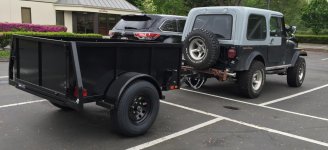

More pics of the CJ..
Sure... I am always down to share Jeep p0rn. Couple of Specs: Original in-line 6 rebuilt. Fuel injection and ECU added, T5 5-speed ******, Ford 9" rear end, big ol' Branco brakes, Skyjacker lift and suspension, 9,000lb winch, sway bar disconnect, all three tops, full Rhino lined interior and fender wells, and 2.4 million candles of KC lighting.
These were shot today at your request in the parking lot at work. I have my custom built 4X6 trailer (225 tires, etc.) latched on because I am picking up two doors and 4 windows after work. My Speedo when it rolled 200K is also pictured and I threw in the WRX just 'cause I can.
