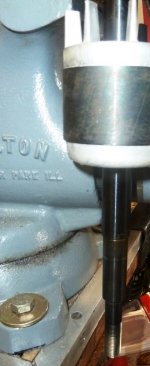

Method 1 - Soft faced hammer and vise. (my personal least favorite)
Important - To avoid damage to the rotor/shaft, use soft faced covers for the vise jaws. ie - copper, wood, plastic, ...
1) Install the rotor/bearing assembly in the vise, DO NOT tighten the vise jaws onto the arbor/shaft.
Note: To avoid damage to the arbor/shaft/threads, leave the shaft nut installed, with the shaft threads BELOW the top of the nut, not as pictured below.
2) Support the bearing/shaft assembly on the vise jaws, with the jaws as close to the bearing inner bore as possible. DO NOT tighten the jaws, the assembly should be free to move downward in the following steps.
3) Insure the 'lower' part of the arbor/shaft/bearing assembly is free of any obstructions.
4) Using the soft-faced hammer, hit the shaft nut, driving the arbor/shaft downward and away from the bearing.
