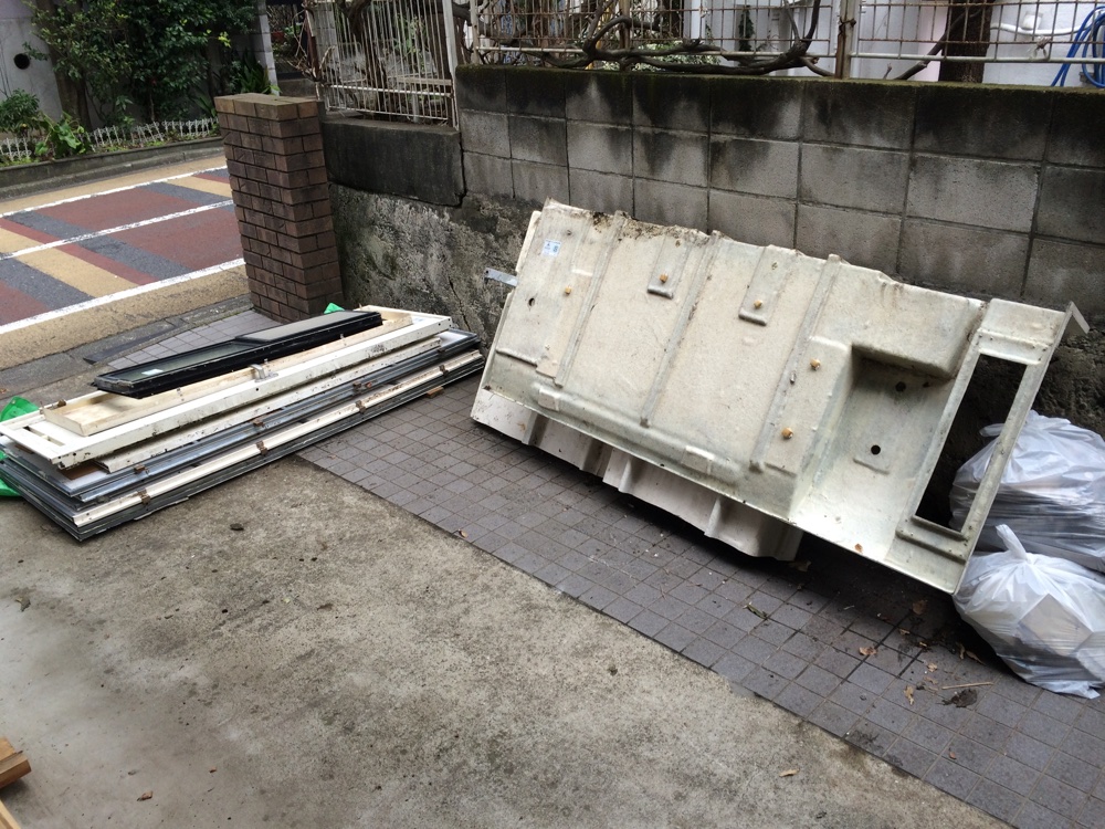

The other challenge over here is what the hell do you do with the old toilets. In Japan, anything over 30cm in length or is non-burnable is ‘oversized’ and requires you to call the county to arrange pickup. You must attach special stamps that come in various monetary increments with your name and address, and they do not take a ton of things that you would commonly want to dispose of. Electronics and appliances must be sent to private recycling facilities, and things like a toilet are not something that any Japanese actually replaces by themselves. Taking the old toilet is done by the installers who presumably have some arraignment with an industrial recycling facility, our local county trash facility took a great deal of convincing and pleading before they would agree to pick the old ones up. I was seriously considering reducing them to small pieces with a sledge and sprinkling them into the once per month un-burnable trash pickup over time (something I do with many things these days…)

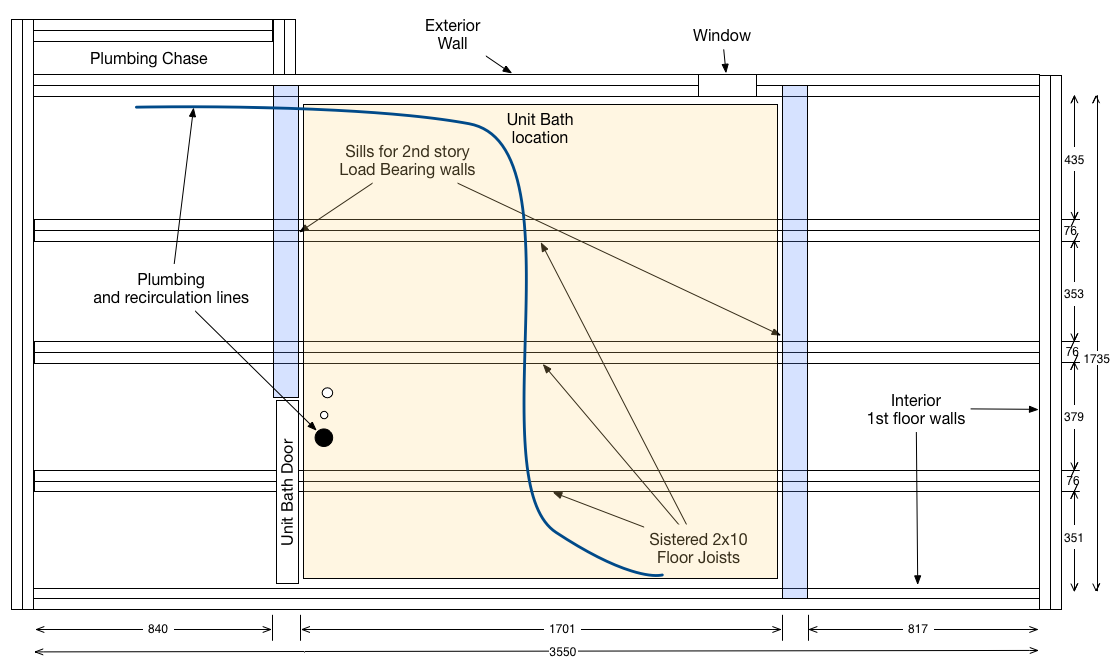

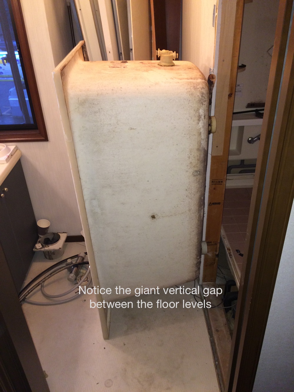

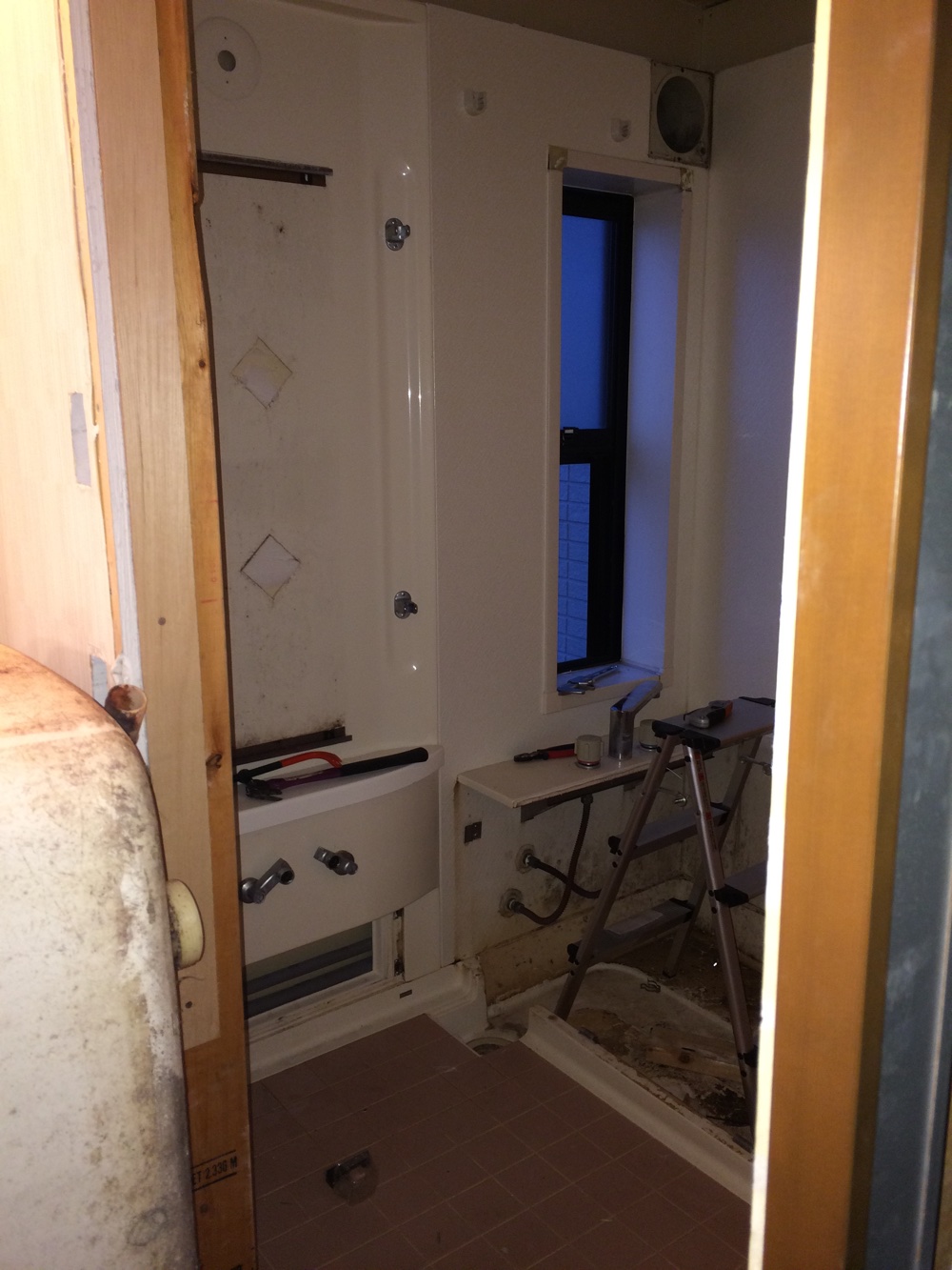

The existing unit had a single fiberglass floor pan with ceramic tiles epoxied into a depressed area around the main drain. A separate depression cradled the cultured marble tub which was hooked to the bath loop. As I mentioned, Japanese need to reuse the bath water, often over several days. The way their water heating systems work, this is something that can be done quite easily. You may be already aware that Japan almost exclusively uses instant water heaters. They typically have a small unit dedicated to the kitchen, and a larger unit for the bath and bathroom. The bath heater is typically equipped with two wired remotes, one located in the Unit Bath, and the other in the living room. The heater has two separate heating coils, one for fresh water, and a separate loop that can switch from a fresh source to a recirculation from the bath itself. Japanese baths have a special receptacle that has two hoses connected, one is a supply from the heater the other is a return line from the tub allowing it to easily maintain a set temperature or reheat the water. The heaters are very precise in the water temperature they provide, and you can set the two circuit temps separately. The remotes can automatically fill the tub to a specified level, and then alert you with a little song and recorded voice (the reason for the second remote) when the bath is ready. The two remotes are also handy as you can page your partner from the unit bath remote for a fresh beer while you are soaking. The controllers are quite sophisticated, with timers to have a hot bath ready when you get home and various other conveniences. This reheating loop has to be serviced by an integrated pump (very old systems just used thermal differentiation), which is one of the reasons why I mentioned most baths were located on the first floor.
The walls of the unit were made of a very heavy cement board faced with a textured epoxied steel sheet. It was held together with special clips and sheetmetal screws. Getting the two steel roof panels off first, I was then able to unstitch them without too much trouble. The tub itself weighed a million pounds, and me and my wife had to rotate it in more directions than an olympic diver to get it out of there and down the stairs without having to break it into pieces.

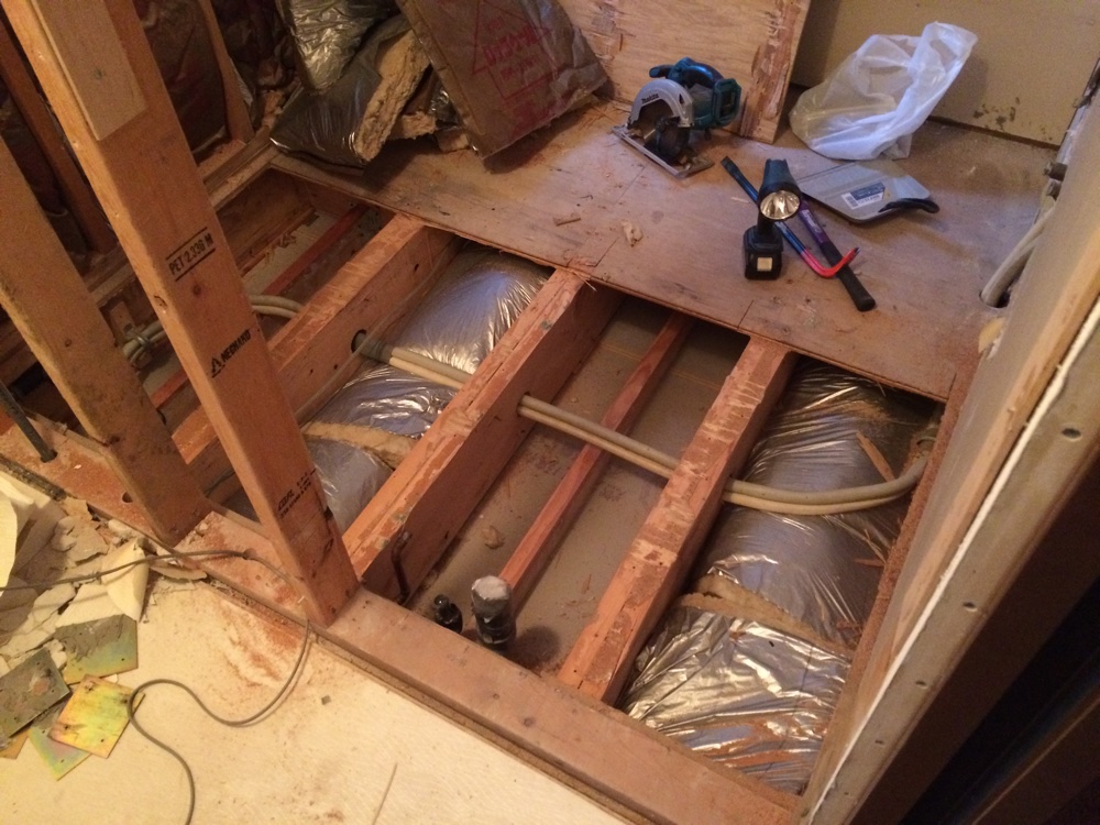

I used a cold chisel to knock out a line of the tiles, and the sawzall to cut the square steel tubing and fiberglass pan into two sections so it could be removed. The pan stood on six large threaded rods heavily epoxied to steel plates screwed to the sub-floor. I ended up having to use a hydraulic jack to free them from this arraignment, it was clearly meant to be permanently mounted.
I then started my examination under the sub-floor. I had a plan, but it depended on what was in there and if I could find a unit bath that would work with western “2x4” construction. What I found was the floor under that bath consisted of sistered 2x10 floor joists, with horrifyingly large mid-span holes for the recirculation lines, but otherwise conforming with my hopes. What I intended to do was box out the entire area, and mount the new unit bath into the gap suspended on a steel frame. Much to my delight, there was such a mounting kit available for the Lixil line of Unit Baths, and so I needed to start designing how I was going to cut a 2 meter by 2 meter hole in the middle of my second story floor without collapsing our 3 story house. I also needed to make sure that the new framing I was going to install was not going to impact the strength and integrity of the house, and would support a Unit Bath full of water and (at least) two adults :)

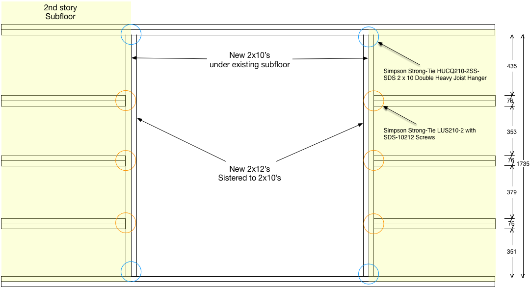

Here is some simplified drawings of what I intended to do.
Before:
After:

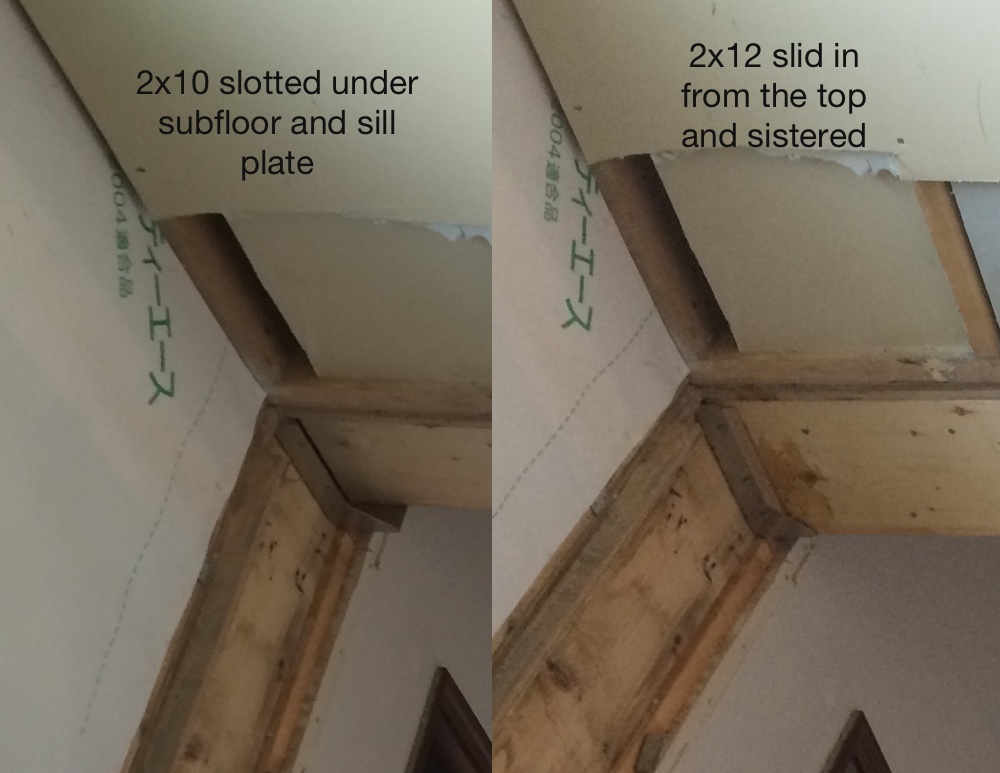

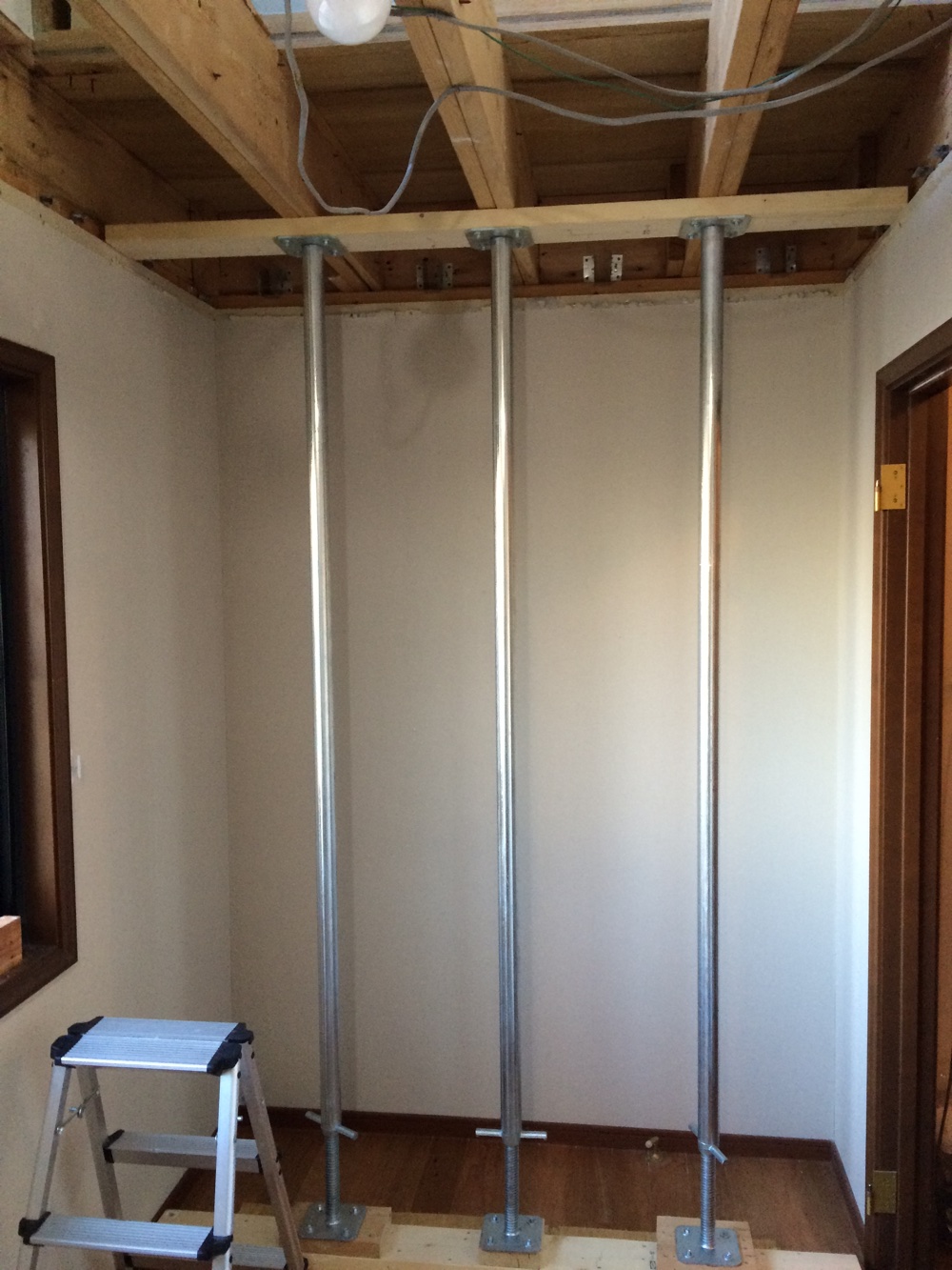

As I’ve said, western construction is very unusual here in Japan. Most high end framing is done with beautify notched and pegged framing beams, modular steel beams or reenforced concrete construction. I could order dimensional wood, actually they have a special grade in the US and Canada reserved for the very demanding Japanese market, but the sort of hardware I wanted was just not available here. Fortunately I still have family in the US and so I have them ship me items from there regularly. I special ordered 4 Simpson Strong Tie stainless steel heavy duty double 2x12 joist hangers and their matching hardened lag bolts.
Because of the exact dimensions I was dealing with I could squeeze one 2x10 under the subfloor, then glue and sister a 2x12 to it, giving me as much support as possible, but leaving just enough space ( a few mm) for the steel support frame. To be frank, I think the span was a bit over engineered, but that’s the point. In order to actually cut all these joists without imploding the house I had to construct some temporary supports under the load bearing walls. To do this I utilized the ubiquitous steel scaffold poles that are used here in Japan with jack screws and 2x6 top and bottom plates. These were lagged into the bottom of the joists, and allowed me to carefully cut the spans with the help of a special zero clearance blade for my jigsaw, as I wanted to allow the subfloor to overhang one of the two new beams.
Because of the design of the Strong Tie brackets, they were shaped like a U with the bolting flanges inside the U section. This means that you had to bolt them onto the sills first, then slip the new joists into them from the top, covering up the bolts. I believe this is done so that in the case the bolts try and back out, they run into the joists and are forced to sheer rather than tear out. Because one of the new joists is located under the existing subfloor and wall sill plate I couldn’t put them in as one beam, I had to slide in the first one, move it under the subfloor and tack it in. Then slide in the 2x12 after it with glue between them, nailing through it and the 2x10 into the **** edge of the doubled joists I had cut.
They were then reenforced with heavy duty doubled 2x10 joist hangers. I used a mix of Simpson stainless steel nails (expensive but beautiful) and special SDS Strong Drive lag bolts. I measured the deflection before cutting the joists, when they were cut and supported by the steel temporary supports, and when the new sections were in place and there was no movement at all.

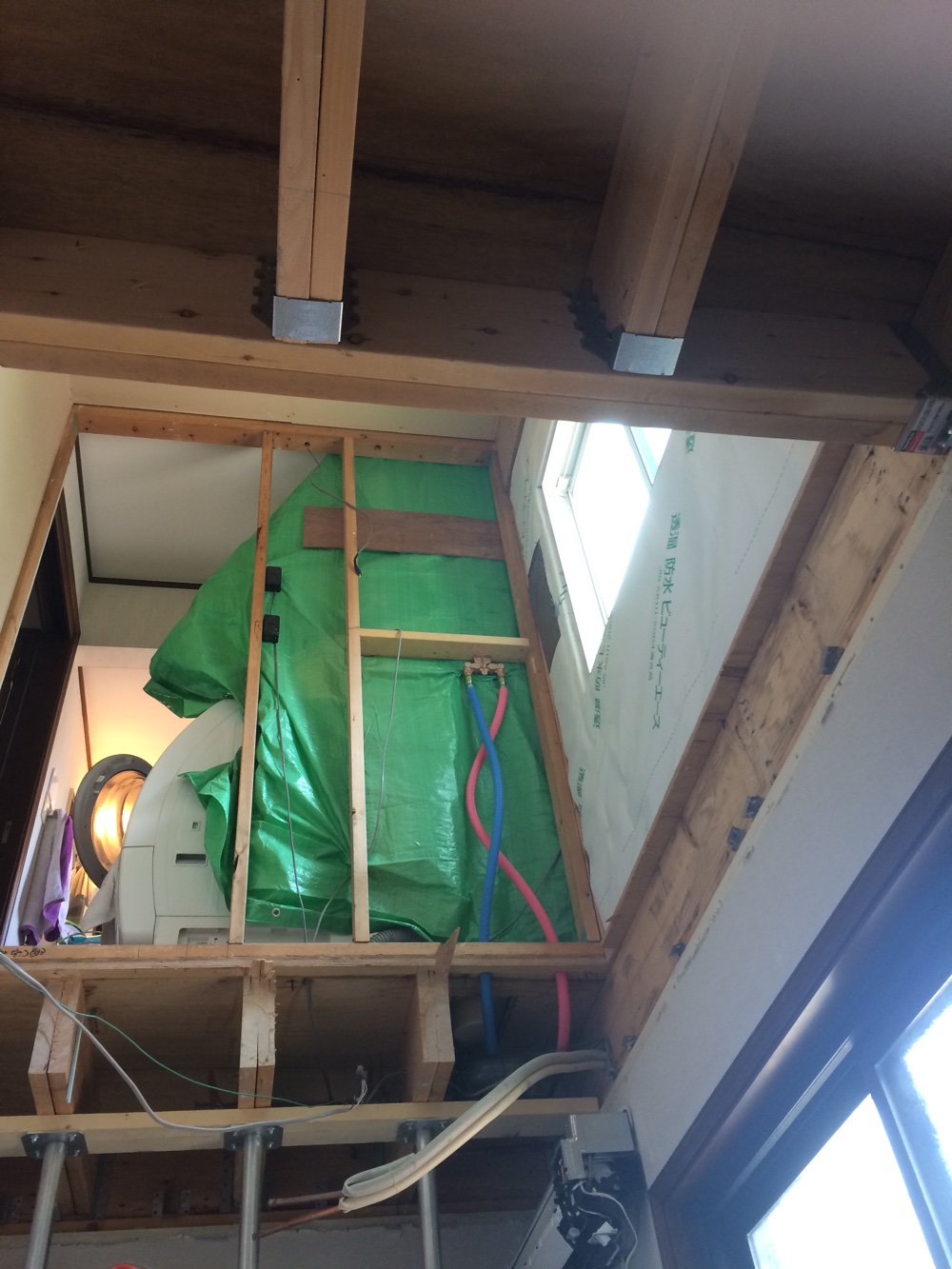

Here's one more shot from below, showing some of the framing details of the completed side. The unfinished side and its steel support bracing. Some temporary plumbing I will explain later, and the gaping hole my very tolerant wife allowed me to make in our -way out of our price range- house...
This room where the picture is taken from is where my shop, and eventually the main subject of this thread (one would hope) will be.

These "Speaker Trucks" are not just used by the recycle scammers and Yam vendors, but they are used every year for political advertising. Politicians are not allowed by law to make any policy speeches, so they have these trucks and micro vans race around saying, "Hello, I'm Mr. Takata." Basically just saying their name over and over again. Loudly. The other users of this sound blaster technique are the crazy right wing nationalists (yes, we've got them over here too.) Often tied to the Yakuza, they drive around in menacing militarized flat black painted vans with tinted windows, ignoring traffic laws, blasting old patriotic Enka songs and political rants about taking back the Northern Islands from Russia, kicking out all the Koreans (who have lived in Japan for multiple generations, but still are not given citizenship) and other nonsense. So, I guess that explains why no one passes (or enforces) any laws in this regard. In the US one of these trucks would last about 5 minutes before they became “Tactically Disabled", one of the few instances when I am seduced into thinking guns in the public's hands might actually be a good idea...
Anyway, I didn't answer your question. Other than the Unit Bath, the bulk of the waste material I generated was gypsum board. It actually makes very poor landfill material due to degenerating into Hydrogen Sulfide when it interacts with water, but it isn't a super common building material here so they don't have any specific recycling facility (that I could find anyway.) The municipal bulk pickup refused to take it (I think they didn’t know what it was) and there is no such thing as getting a 'dumpster' and just filling it up with trash over here. I know things have probably gotten more restrictive in the States since I left, but it still must be far easier to deal with this sort of thing.
So the scrap wood had all the nails pulled and was cut piece by piece into little 30cm^3 bundles and carefully tied with string. The sheetrock was similarly cut by hand into 10cm squares and packaged neatly into plastic bags. The unwritten rule is, the more neatly you package the trash, the more likely it is to be picked up :) These little ‘treasures’ were doled out to the regular trash pickup on the appropriate days over many weeks to keep from raising any red flags. I kept as many of the larger pieces of Gypsum board for reuse as possible, since getting sheetrock over here is very difficult. My house primarily uses 5/8" (18mm) panels which are not even stocked by the best professional building supply, but the ceiling of the shop was originally done with two layers of 12.5mm to reduce the noise of the shower and bath from the floor above, and they do stock that.
The Bathtub and Toilets, cement and steel wall panels, Unit bath floor pan, door and window were all carefully stacked and tarpaulined in my driveway for months while we negotiated with the municipality to pick them up. My wife had to prove we were not doing it as some form of business, they were completely dubious that a homeowner would replace their own Unit Bath, and it wasn't until I insisted they send someone out to inspect the gaping whole where the bath once was did they agree to pick it up. They sent a sizable truck with 3 guys and we worked together to load everything up in about 30 minutes. The total cost was maybe $30-40, with me applying $1 and $5 stickers to each piece based on the eldest man's wizened cost estimates. It was a relief to have it gone as the neighbors only have so much tolerance for eccentric foreigners collecting piles of garbage...
Here is part of the pile prepared for inspection and pickup on trash collection day:
So, I basically cut stuff up into small regular pieces with my power tools, package it neatly, and slip it into the correct trash pile under the cover of darkness. So far so good.

Rear Window
The existing window of the previous bathroom was located in the corner and dimensioned in order to minimize the amount of cutting they had to do on the cement and steel panels used by the old system. As is still very typically used in new construction, the unit was an aluminum framed single pane (uninsulated) window. It was in a crappy corner location, and barely allowed in any light. The exhaust fan above it was basically directly open to the outside and allowed the most gentle of icy breezes to enter and bite tender flesh. One of the options for the new bath we selected was adding an insulated modern window, so I opened up the wall to see what I was dealing with and how I would go about putting something decent in place.
I found a bit of a nightmare:
This was exactly as I found it, no lower sill, just some random pieces of wood and trash laying there. The fan wasn’t any better:
Look at that hackery! Clearly there were some design issues that were best resolved by chopping up a load bearing post… Yeesh. Do note that that spring mounted damper is held open by a thermal fuse (the bow tie looking thing at the bottom.) That’s in case of a fire, it will melt and close off a possible source of oxygen.
It was clear that I was going to have to cut several studs as well as repair and enforce where the old window was located, as there was only a small amount of overlap with the most reasonably sized window we wanted. Again, this is the second story, I had unfortunately already pulled up the whole subfloor at this point, so all my work was done dancing across the joists (let that be a lesson about sequence!) This wall was basically a meter from a heavily trafficked street, (on a blind corner) making ladder access somewhat precarious and about 2.5 meters from the ground at a sharp angle. I already have (I believe a healthy) fear of heights, and so accessing this was basically going to be quite risky.
Rigging some form of support (like the steel scaffolds seen in previous posts) was much less plausible, as there were nothing like a British “Strong Boy” offset that could hold up that section while i cut the studs to insert the new window header. So given that I had a bit of room above the window, I added all my supplementary studs, then created a boxed section with the best 18mm plywood I could find, leaving room for the actual header beneath it.
Here you can see the initial framing and blocking, with all the new stuff using Simpson SDS lags. The bottom of that shorter sistered stud is where the top of my window header beam will set.
I had to remove the existing window to make room for the new post I made to support the window header. Here is what the outside of the house looked like for a while as I worked on reenforcing this area as I prepared for the “big moment” where I cut several load bearing studs. Yes, that’s snow falling, the plywood window replacement increased the R value by a considerable amount :)
So here’s a consideration that needed to be made. You see that strange wavy gray siding that clads the outer surface of my house, much as a doggie landmine complements the bottom of one’s Vibram sole? Yeah, you can’t buy that anywhere. It is a highly mineralized epoxy pressboard embossed with an irregular brick like pattern that is formed with a shiplap and is held to the sheathing with special aluminum clips. You can not remove it without removing the section above it, meaning start at the top, and work your way down. My ladder wasn’t anywhere near 4 meters tall, and there was no way I was interested in unstitching the whole side of my house while hanging from a rope or something equally idiotic. That stuff weighs as much as lead too. So I had to find a way to create the correctly sized opening 2.5 meters from the ground, and salvage enough material to repair the large area where the new window didn’t overlap the old one.
I did a ton of technical drawings covering that area looking at what I needed to remove and how to piece it all back together in a way that would fit with the material I removed. It was a very stressful puzzle. Then I carefully cut the uppermost section’s tongue, above where the new window would go with a multitool, and gingerly removed it from the wall. This was all done with a harness and safety rope while I stood on the most unsettlingly angled ladder tethered to the wall to keep it from vaulting me into the traffic below. This allowed me access to the aluminum clips, and I could unstitch the rest of the panels down from there. This tongueless panel would be relocated to the bottom since it would need to be cut down anyway, I only had millimeters of tolerance before I would need to sacrifice some unseen area of the house to provide material to cover up any mistakes. The siding will be replaced with something more elegant down the road, but for now, it is what it is.
Having insulated and nailed up the interstitial box section header, I began the harrowing removal of the studs. You can see in the picture below the 2x6 based beam I made to help reenforce the existing beam that was hacked up by the butcher who installed the fan. The hacked section was removed and replaced with new material and would transfer its load through the window header to this beam. The new window header and beam were made by sandwiching high grade plywood with 2x8’s and 2x6’s respectively, with tons of glue and nails to keep them together.
Nothing sagged or creaked, I worked as fast as I could getting the header into place and getting all the jack studs and steel reinforcements lagged and nailed in. Now I had a proper frame in place to put the new window.
From there it was just cutting the hole, carefully replacing the affected vapor barrier, using the wonderful 3M 8067 Flashing Tape (from the US) to seal everything up and sliding in the new window with the help of my wife who took this rare action shot.
A couple of tubes of high quality silicon ****** later, we have this:
You can see the amount of siding I removed, now I had to carefully cut, biscuit join and rearrange the left over materials to make it look factory.
You may notice that there is some minor color matching issues with the paint. It isn't as noticeable in real life, the camera seems to pick it out. In Japan you can’t go to the paint store with a color sample and have them scan it with a colorimeter and instantly mix you up a match, they don’t do custom colors. In fact you only have a set color palette of pre-mixed colors that you can (are allowed?) to choose from. Even if you get the right color code, when the paint has been exposed for many years, it obviously isn’t ever going to match :-/ Japan is full of unexpected, inexplicable and tedious little issues like this.
