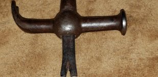

"Thayer's Patent" Civil War era combo tool
30,996
I don’t mind coming home from the flea market with only one tool when the tool is something like this one.
View media item 77715
Here it is cleaned up and in some better light on my workbench.
View media item 77717
View media item 77716
View media item 77722
View media item 77723
View media item 77721
View media item 77719
View media item 77718
It was patented (#35,715) by John Adams Thayer during the Civil War (June 24, 1862) as a “combination tool.” Here is the diagram from his patent application.
View media item 77726
He described it as a “shank or bar graduated to form a scale” with a “screwdriver and a claw on the ends of said shank or bar,” with an adjustable “handle or sleeve” and an adjustable “hammer-head.”
See the thumbnail below for a more complete example of this tool from the Donnelly Antique Tools Auction site. The idea is to slide the handle/sleeve and the hammer head away from their respective ends to use this as a screwdriver and claw, and back down into their end positions to use it as a tack hammer and tack puller. As shown in the two diagrams on the patent. My example is missing the sleeve/handle and also the set screw for adjusting the position of the hammer-head.
Speaking of the hammer-head, mine is frozen in place at the moment, but in a position where just enough of the marking on the shank is revealed. The whole marking reads “THAYER’S PAT” over “JUNE 24, 1862.”

This old scrounger is tickled maple mahogany to announce that his formerly one-half of a c. 1862 Thayer's Patent "Hammer with Nail-Claw, Tack-Lifter, Screw-Driver and Rule" is now whole! :pimpflash
Kudos and a round of applause to @Mintgrun. 👏
I'm not going to spoil his fun even trying to explain his process. His approach was meticulous, collaborative, and sensitive to my aesthetics, and I have plenty of PM in-progress reports with photos and descriptions. But he deserves the well-earned spotlight and I invite him to post his work here as he sees fit.
If you scroll up to my first post you'll see a patent diagram that shows winged set screws, but none of the surviving examples I have seen on-line exhibit those features, and we concluded that they may not have been made that way by any of its three (at least) manufacturers once the design hit production. I tried to source them at an 80-year-old hardware store here, and online, but finding two matching 8-32's, one brass, one steel, same style, period correct, proved difficult. So he made those for me as well as the brass end caps, "torch-ering" them (to borrow his coined term) to age them, copying the hardware on surviving examples found in museums and various upscale antique auction houses on-line.
I will simply say that I couldn't be happier with how it turned out. The shape is perfect and it looks splendid and convincingly old yet well preserved, matching the condition and finish of the shank and hammer head, which was exactly what I asked for.

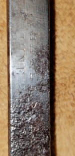

I found a marking I had not seen before, because I had never slid the entire hammer head off, with the shank being bent. A "C" inside a diamond. I am betting it's for Clifford & Company of Boston, one of the three known manufacturers. See the trade journal snippet in post #15.
And here are more photos showing the branding and patent notice, the rule, the dimples in the shank for the set screws...
...and the tool completely dis-assembled.
The most popular configuration for photos of this tool is one in which the handle is slid slightly up and the hammer head slid slightly down, as I led off with in post #20, because it shows all the tack-lifter and the screwdriver. But that is not the positions of the dimples.
This is with the sets screws in the dimples.
But it would have to be used something like this for the tack puller and the screwdriver.
