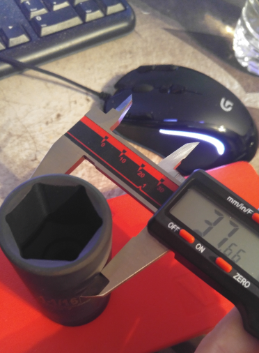

I realize that the CR-V vs CR-M debate will rage on forever and that there are differences beyond just the type of metal.
Does anyone have a Capri , Sunex, or similar CR-M 1 1/16" impact socket in 1/2" drive that they could measure ? Or a CR-V impact in that size from a brand other than Tekton?
If I have a couple measurements I can just compare.

I have a Cr-Mo from my Klutch set in 1 1/16 deep is 37.95 mm
All my CrV stop at 1 inch I have two different brands of import the Klutch is 36mm and the Great Neck is 35.9

Interesting.
The Tekton shallow impact CR-V 1 1/16" is 37.89mm
Gearwrench shallow regular shiny chrome 1 1/16" is 35.73mm (this one just fits the recess)
This is leading me to believe that I should be looking for a 1 1/16" thin wall impact.

Anyone have a couple more outside diameters? Or even just a 1 1/16" 1/2"dr impact that measures an outside diameter under 36mm?
Thanks,
Seth
