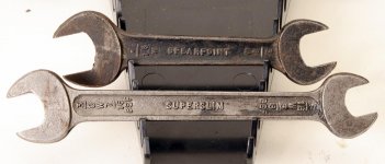

It's been a couple years since I posted these, I've always though the Spearpoint may be made by the same manufacturer. Superslim has a bathtub basin in the handle and the spearpoint doesn't but otherwise they are similar and I ofter find them together.

Thanks for posting these pics. Interesting comparision you make and show between Superslim and Spearpoint :thumbup:

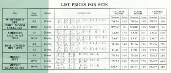

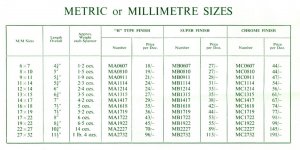

I now have the pages from the 1965 catalogue for these.. still got to get a few more to complete my collection, mostly larger sizes in AF and Metric.
Good work finding these lists. Thanks for posting them.
I note 18 Whitworth sizes on the list, thought I had most but have 6 wrench size pairings not answering the roll call.
I'll try to find my tray of A/F spanners tomorrow and report back.
Thanks. I will go through the lists soon and check off which ones I have and see exactly what's missing.
I do have one which is not on those 1965 catalogue lists. I know some of my spanners are a few years older than 1965 (so am I !!) and the advert I have is from 1956, so probably the list changed over the years as they were made for at least a decade.

Here's some pics and info kindly sent by humber2, I think I have managed to attach the pics by loading them early morning when the internet is a bit quicker! I first saw a 'British Made' one only a couple of days ago, on ebay. The older type with no recess in the handle turn up quite often for sale in UK. Thanks for all the extra info humber2.
Humber2 says:
I'd like to establish a date for the "bathtub" Superslims and it appears from Grace's Guide the blue pamphlet of 1951 may be pretty close.
My first image is for two TW's older than 1951.
I collect Whitworth tools from all manufacturers.
The early WW bathtubs just showed the WW size.
With the British Standard revision c 1952 toolmakers generally revised the dimensions.
Looks like initially WW and BS was used.
Then WW and BSF
So there are three series of "sets" to be found.
To make it harder there are examples of British Made before Made in England too.
Image 2 shows these options.

Here's the other full scans of the 1965 catalogue pages the museum sent me. It shows the later pattern of chrome vanadium spanners already being produced, so the ones with the recessed handle design probably lasted about 20 years in production maybe a bit longer and included the progressions shown by humber2, but by the early 1980's I'm pretty sure they were replaced by the later design of spanner which is actually a bit slimmer. I have a couple of those that came new with a Marshall tractor in around 1982.

Here's the update of progress so far, following the example of woodland_hank to display as in a catalogue listing.. I'm only trying to collect all the sizes and disregarding the different finishes.
Working from the 1965 catalogue listing, here are the sizes of TW Superslim spanners I am still looking for:
AF sizes
3/8 x 7/16
3/4 x 13/16
13/16 x 7/8
7//8 x 15/16
1 1/8 x 1 1/12
Whitworth sizes (these also have the BSF sizes on them, I'm just noting the Whitworth not the BSF)
1/2 x 5/8
9/16 x 5/8
1 x 1 1/8
Metric sizes
11 x 14
14 x 17
19 x 22
22 x 27
27 x 32
and already got extra to the catalogue listings
9/16 x 3/4
22 x 24
and got 'Colchester Lathe' versions
11/16 x 9/16
1 1/8 x 3/4
1 5/16 x 15/16
