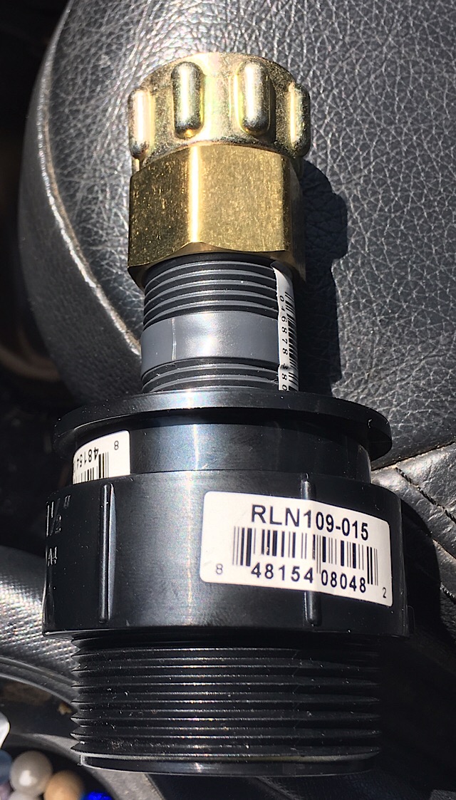

First of all, if you buy a pool kit like this, it will come with hoses terminated with 40mm metric threads (all hose ends are female) to connect the pump and sand filter together. I added a salt walter chlorinator (again, from Intex) which uses the same hoses. If you're planning on adding in solar, you'll want to purchase the hose adapters below, and a few extra 40mm hoses as well. Both can be found on Amazon. The hose adapters take the 40mm female hose end to a male 1 1/2" thread so you can use standard ABS or PVC fittings to plumb in your solar. Intex 1 1/2" hose actually uses a 40mm thread..so you'll need the adapters.
You can mickey mouse your own fittings, but keep in mind that a 7000 gallon pool makes a pretty big mess if a fitting fails! I played with a few iterations and just ended up using these adaptors from GAME. My brother has a similar setup and tried cheap Intex solar mats. Not only did they fail, but his pool was drained twice because of this!
You can see the adapter used in the following pics. Why do you see both ABS and PVC? I started using PVC and then realized that the less expensive ABS is more than adequate given the low pressures and temps at play here.

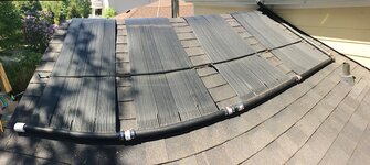

I've done something unconventional and draped these collectors (they are 20 ft long) over the peak of my kitchen roof..which is about 16ft away and 15ft up from the pool. I was thinking air entrapment would be an issue, however it's not proven a problem.
This is the view of the panels on the intake side, looking down. I've made a manifold of sorts so that each side of the 2ft wide panels is now an intake, and far side (previous pic) are where the water exits the panels. The manufacturer has the panels set up so that water enters and exits the same end..with the far end blocked off. This forces a 40ft water path through each panel, which proved far too restrictive for my setup. I've plumbed these basically in a parallel configuration which is what the pros recommend. Having tried both, I'd agree. Flow was terrible when set up as per the manufacturers recommendations. Keep in my mind that I'm using the standard 1600 gph Intex pump that came with the pool I did not want to up a separate solar circuit and motor. Thankfully, the Intex pump has enough head to run water through these panels, once they they were plumbed as a paralel non-cross flow config. (I tried several configurations!)
This is the view just below the kitchen roof where supply and return are plumbed. The black/green bit in the middle of supply is a combination vacuum relief/bleeder valve.
You might think that this valve should go at the highest point of the solar array, however this did not work. Suction (from return water) kept pulling the floating ball contained in this fitting downward off its top seal, allow air into the system while the pump was running. Putting it on the supply side worked far better as the pump pressure now keeps the internal sealing ball properly pushed up against it's top seal. When the pump turns off, the internal check ball drops down and allows air into the system, ensuring all water in the panels can drain back to the pool. This prevents suction in the system from collapsing the panels. A vaccum relief valve is another "feature" that you would (or should!) find in any professionally installed system. With a more powerful pump I likely could have moved this relief/bleed valve higher in the system so it would serve as a high side bleed as well as vacuum relief.
I should mention that I tried a few configurations, and this one works best. Why? Flow to the pool (again using the standard 1600 gph Intex pool pump) is very good..almost as good with solar as without. Also, temperature gain is about 4-5 degrees F on a sunny day, which indicates high efficiency. The goal with solar pool heating is very high flow, and a low temperature differential. This in turn maximises BTU gain to the pool. On one of the early days of use, I calculated about 460 000 BTU gain in one day. This is calculated taking (gallons X temp gain in F X 8.33). Our back yard is completely shaded virtually all day, so solar gain is pretty much via the solar panels only.

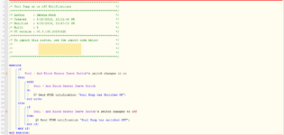

I added a SmartThings "virtual switch" (you need to do this in the web IDE) so I could turn the pump on and have it ignore the automation code that turns the pump on and off. The code I wrote using WebCore in SmartThings turns off the solar logic if this virtual switch is "on". WebCore is an app you can add to SmartThings that allows you to write pretty complex automation code in any web browser..freeing you from the iOS app. My little apps (called Pistons on the webcore world) are very simple.
This one turns the pool pump on if the roof temps exceed water temps by six degrees F., and turn it off if temps are less.
This bit of code sends a notification to our iOS devices if the pool pump is turned on or off:
Finally, this bit of code turns the pump on or off and pauses/resumes the solar control app if one turns the pump virtual switch on or off. This way the pool pump can be run regadless of the water/roof temps.

Tommy, no issues with the collectors so far. We'll see how they fare after our rather drastic winters here.

Finally, with the two added solar collectors now on a higher portion of our house roof, the Intex pump could not lift the 17ft of so now needed. I measured power use of this pump at only 100 watts, or 1.4 amps. This is in the order of 1/4 HP, and less than the spec sheet of the Intex SF80110-1 pump. I have a 2 speed 1 HP pump coming in which should do the trick, and make pool vacuuming a lot faster too.
I had lots of help this year as the girls were anxious to get swimming!
Our tap water is very cold this time of year, in the order of 45F, so getting in the pool to addresss liner wrinkles during fill is torture. This combination of bits from HD allowed me to fill the pool via the solar system. With reduced flow, the 45F input water was exiting at about 70F, making it much nicer on the feet :) The brass end is a female coupler for a garden hose, the other end is 1.5" pipe thread to attach to my PVC solar plumbing.
By my rough calculations the new pump and 50% increase in solar collector area should result in about 600 000 BTU on a good day...a solid 10F increase. The science project continues..
